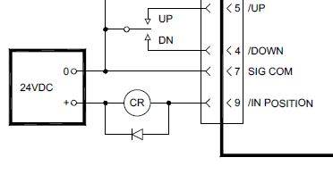

I have been working on a circuit and the manual shows a diode in parallel with "CR". I think it might either a control relay or a crystal rectifier. I am having problem building the part between +ve terminal of the 24VDC power supply and the 9 /IN POSITION terminal Can anyone please help me figure out how to achieve this circuit? This is a part of a control panel for a torch lifter system. Any input would be appreciated.
CR is the coil for a control relay. The diode is there to protect associated circuits from flyback when the magnetic field in the relay coil falls.
Likes davenn
yes agreed and the contacts for the said relay are the ones you see just above it, the single pole double throw
