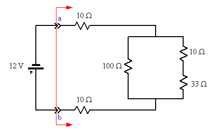

The first problem ask to find the total equivalent resistance. That would be the net resistance "seen" by the battery. If you "cut" the circuit at the points a and b as shown in the diagram below, what is the net resistance between a and b? You'll want to simplify by combining parallel and serial resistor pairs until you're left with a single value for the total resistance.
Let's see how you do on that before moving on to the next part.

Hi Gneill,
I'm not sure if I did this correctly but here...

Nevermind, it wasn't.. Tried something else like this:
1/ (143/4300) + 10 + 10 and got 50.06. The correct answer.
Can you explain why there's a 1 over the parallel?
So the formula I have is
1/parallel = 1/R1 + 1/R2 ...
Using that, I get the whole value for the "parallel" portion of the formula. But to get the correct number I need to divide 1 by the number I got for the "parallel" part.

You didn't finish the calculation for the parallel resistance: you left off when you'd added 1/R1 + 1/R2, and failed to take the reciprocal of the sum.
A handy way to calculate parallel resistances when there are only two involved is ##R_p = \frac{R1\times R2}{R1 + R2}##. The general formula of the reciprocal of the sum of reciprocals boils down to this when there are only two resistors involved.

I'm just trying to understand why I'm supposed to take the reciprocal of the sum... Why can't it be ready as in: Parallel = 1/R1 +1/R2... :smile: ?
And that is an awesome formula. Now I just need to remember it :P
It comes from the addition of conductances. Conductance is the reciprocal of resistance, so letting G stand for conductance, ##G_T = G_1 + G_2 + G_3 ...## when conductors are in parallel. Since resistance is the reciprocal of conductance, it stands to reason that ##1/R_T = 1/R1 + 1/R2 + 1/R3 ...##

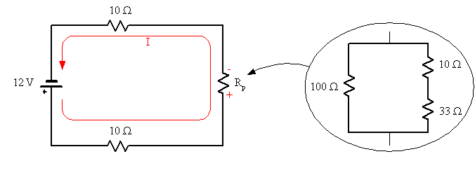

Ha! Start by finding the potential drop across the "parallel block" resistance, Rp :
Once you have that you can narrow your focus to that portion of the circuit; two parallel branches with a known potential difference across them both.

That's the potential drop across the total resistance; it's the battery voltage across the net resistance of 50.06 Ω, yielding the total current ---> I = (12 V)/(50.06 Ω). The "parallel block" Rp will drop only a portion of it.
This total current I flows through a 10 Ω resistor, then through the Rp, then through another 10 Ω resistor. Since they're in series, they all have the same current passing through them. Each resistance will produce a voltage drop due to the current flowing through it (their sum should be equal to the 12V total).
You can work out the individual voltage drops across the resistances in this path using Ohm's law: V = I*R. What's the voltage drop across Rp?
Can you then find the current through the branch of Rp containing the 33 Ω resistor?

I got it! Part of it!
2.39V for each 10. and 7.18343V for the block entirely.
10.277V for the portion of the block with 33.
23.9V for the 100ohm branch of the block.
Yes, those look pretty good for those voltage drops. I think if you keep a few more decimal places in intermediate results you'll find that the drop across the parallel block is closer to 7.207 V.
Oops. No, You shouldn't ever find voltage drops larger than the total voltage being supplied. The total current divides in the parallel block; a portion goes through the 100 Ω resistor, and what's left goes through the 10 + 33 = 43 Ω branch.
This is where you make use of the voltage drop across the block; Parallel branches share the same potential difference across them. With about 7.2 V across the 43 Ω branch, what's the current there?

The total current was 0.239 and it divides into the 43 and 100 branches. Unevenly.
Itot x Rblock = V block = 7.18 or 7.2V
7.2V/Rbranch = Ibranch
7.2/43 = .167 in the branch.

Okay! Since you now know the current in the branch with the 33 Ω resistor you can find the power it dissipates using the formula mentioned before: P = I2R.
Since you explained that you haven't got a lot of circuit analysis rules and techniques in your "toolkit", the method I presented made use of what might be referred to as bare-bones or "brute force" techniques; Basic resistor combinations and Ohm's law to find potentials and currents at successive "levels" of the circuit. These can be quite effective with a bit of practice, and in some cases faster to use than more sophisticated methods.
Success. .1672 x 33. What boggles my mind is why I would use one of the resistors (the 33) because they both interfere with the current. Good god.
Edit: moreover, our formula sheet doesn't even have that formula. And I couldn't derive it.
