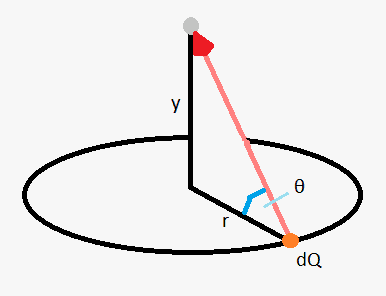

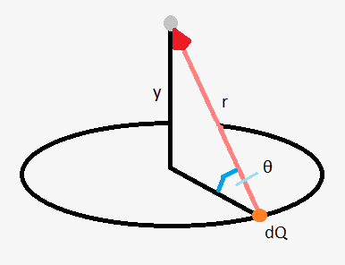

"A straight, nonconducting plastic wire ##x=9.50_{10^{-2}}m## long carries a charge density of ##λ=1.3_{10^{-7}} C/m## distributed uniformly along its length. It is lying on a horizontal tabletop. If the wire is now bent into a circle lying flat on the table, find the magnitude and direction of the electric field it produces at a point ##y=6_{10^{-2}}m ## directly above its center."
##dQ=λdx##
##y=6_{10^{-2}}m ##
##|E|=(\frac{1}{4\pi ε_0})⋅\int \frac{dQ}{(x^2+y^2)}##
Let ##x=2\pi r##. Then ##dQ=λdx=2\pi λ dr##
##|E|=(\frac{1}{4\pi ε_0})⋅\int \frac{dQ}{(x^2+y^2)}=(\frac{2\pi λ}{4\pi ε_0})⋅\int \frac{dr}{(r^2+y^2)}##
##|E_y|=(\frac{1}{4\pi ε_0})⋅\int \frac{dQ}{(x^2+y^2)}=(\frac{2\pi λ}{4\pi ε_0})⋅\int \frac{ydr}{(r^2+y^2)^{\frac{3}{2}}}=(\frac{2\pi yλ}{4\pi ε_0})⋅\int \frac{dr}{(r^2+y^2)^{\frac{3}{2}}}##
Let ##r=ytan\theta##. Then:
##dr=y\sec^2\theta d\theta##
##(r^2+y^2)^\frac{3}{2}=y^3sec^3\theta##
##\theta = tan^{-1}(\frac{r}{y})##
##|E_y|=(\frac{2\pi yλ}{4\pi ε_0})⋅\int \frac{y\sec^2\theta d\theta}{y^3sec^3}=(\frac{1}{4\pi ε_0})(\frac{2\pi λ}{y})⋅\int cos\theta d\theta=(\frac{2\pi yλ}{4\pi ε_0})⋅(sin\theta)=(\frac{1}{4\pi ε_0})(\frac{2\pi λ}{y})(\frac{r}{\sqrt{r^2+y^2}})=(\frac{1}{4\pi ε_0})(\frac{2\pi λ}{y})(\frac{x}{2\pi })(\frac{1}{\sqrt{\frac{x^2}{4\pi ^2}+y^2}})##
Thus, ##|E_y|=(\frac{1}{4\pi ε_0})(\frac{2\pi λ}{y})(\frac{x}{\sqrt{x^2+4\pi ^2y^2}})##.
Can someone check my work, or point out a better way to do this problem? Thanks.

Eclair_de_XII said:
Let x=2πrx=2πrx=2\pi r. Then dQ=λdx=2πλdrdQ=λdx=2πλdrdQ=λdx=2\pi λ dr
This does not look right to me. Your final answer looks incorrect too.
It is simpler to use cylindrical coordinates to describe the charge density. (NOTE: ##\theta## here is in the azimuthal direction and is not the same as the one in your drawing.)
$$dQ=\lambda R d\theta$$
$$\mathbf{E}=\frac{1}{4\pi\epsilon_{0}}\int_{0}^{2\pi}\frac{\lambda R d\theta}{R^{2}+y^{2}}\hat{r}$$
Now the trick is correctly expressing ##\hat{r}##. Can you try that, and infer which component cancels out?
x and r are constants. The circle is not expanding.

This seems an unnecessarily long way around considering that EdeXII already had the right cancellation idea in post #4.
@Eclair_de_XII , following up on post #4, what is the component of the field from the dθ element in the z direction?
If you mean the ##\theta## in my diagram, then I would say that it would be ##sin\theta d\theta##.
Sorry, I forgot θ is being used as the angle above the horizontal to the target. I should have written dφ, where the arc element of the circle is rdφ.
But yes, sin(θ) is the factor to apply to the magnitude of the field. So what integral do you get for the net field in the z direction?

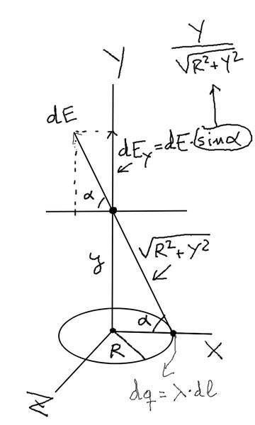

Hello, yesterday I was busy and I could not answer you before. In the problem book the length of the wire calls x, but you can put the integral as lambda · dl if that causes you confusion. I send you a figure so you know what I mean. The only integral is: lambda · dl = lambda · dx = lambda·L= lambda·X=Q, because the other terms are constant and go out.
Of course, if you want you can go to polar ... make a line integral and fill the sheet of paper with equations.
But I've had to make the whole problem !

Your diagram appears to illustrate what Eclair_de_XII did in posts 4, 10, 13.
Yes, I know. It is that for this problem, the only integral is lambda.dl = lambda · L = Q. Sorry for my English I'm not native.
