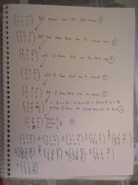

What is wrong with my matrix inversion?
In summary, Fredrik and Mark suggest a different method to solve the homework equation, which does not involve matrix multiplication.

Find the inverse of the matrix:
1 1 -1
2 -1 1
1 1 2

After adding -5/2 times the third to the second (step 5), the number in the middle should be 1-5/2, but you wrote -3/5.

You're not doing it the way I learned to do this. How I learned was to set up an augmented matrix with the matrix to invert on the left, and the identity matrix on the right, like so:
$$\begin{bmatrix} 1 &1 & -1 &| & 1 & 0 & 0\\
2 & -1 & 1 & | & 0 & 1 & 0\\
1 & 1 & 2 & | & 0 & 0 & 1 \end{bmatrix}$$
Now completely row-reduce the matrix on the left to get it to the identity matrix, and your inverse will be on the right. When I did it, there were no "half" entries. Most of the entries had denominators of 3.
First of is this the method you learned in class? Because this seems prone to errors.
You could try Gauss-Jordan Elimination it is essentially the same, but you have some "book keeping" abilities.
It is similar to Gaussian Elimination for systems of linear equations.
[Edit] Too late :)

It's true that OP would have benefited from using some simpler combinations.
However, the method works perfectly well. Fredrik has pointed out where a computational error occurred and Mark has suggest a method with easier "book keeping".
