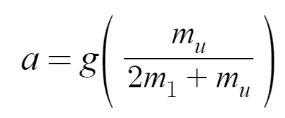

Since m1 and m2 are both 200 grams we were able to simplify the formula. While simplifying we considered that m2 would be (m1 + mu) (mu being the unknown mass). We then got this formula:
We tried out our first mass and it took it 3.3 seconds to travel one meter.
We plugged everyhing into the formula and got
Unfortunately this did not work out for us. We converted grams to kilograms and substituted everything in. We got a calculated mass that was way too low, the objects actual weight is 12 grams. What did we mess up?

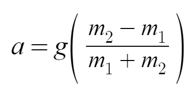

From this data we calculated that the acceleration was (1 meter / (seconds to fall)^2). We then put it into the following formula.
I really don't know where we got this formula from. I also don't know wether the a on one side is expressing acceleration of the system, or just one of the masses.
You're missing a factor of 2 there. If the distance to fall is ##h##, the time taken is ##t## and the acceleration is ##a##, then ##h=\frac{1}{2} at^2##, which gives ##a=2h/t^2##.
The two masses are connected by a string that doesn't stretch, so a is the magnitude of the acceleration of either one of the masses. One accelerates downwards while the other accelerates upwards at the same rate.
Fine.
We plugged everyhing into the formula and got ...
Got what? Is something missing there?
Are you trying to solve for ##m_u##, then, using the measured value of ##a##? Re-arranging your second equation gives $$m_u = \frac{2 m_1 a}{g-a}$$. Does that help?
