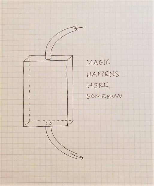

How to pump a fluid with suspended particles, without damaging them?
Hello --
I am working on a project where I need to recirculate a fluid which has a large quantity of glass spheres of say, 1mm diameter suspended in it, but without the pump crushing the spheres. I would appreciate any advice.
To give a simple description of the desired function: it will be a closed system with a vertically-oriented tank about 1m tall by 75cm wide, whose front and back are two sheets of glass spaced a few mm apart. The suspension will enter the tank at either the top or the bottom and will flow to the opposite end of the tank where it will collect and be pumped up (or down) about 1.5m, to start the process again. (That extra 50cm is to account for curved entry / exit tubes, rather than elbows, to use gravity to prevent the spheres from their expected tendency to collect in elbows.) As you might suspect, there is a bit more to the project than that, but that is the gist of it. The real goal is to move the glass spheres; the fluid is just there to act as a circulatory medium.
I don't know yet what fluid would be optimal for this suspension, but the spheres will likely be denser than it, which could affect the spheres' behavior with various pump types.
I have three main concerns: the primary one is to avoid crushing the glass spheres into dust by the mechanical action of the pump on them. The secondary concern is avoiding the spheres causing wear to the pump's parts where they come in contact; I want this to be low-maintenance. And the tertiary is to make it as quiet as possible. It seems to me that impeller pumps might be prone to the first two problems. A diaphragm pump doesn't seem practical here, and I don't want to use anything that reciprocates, due to the noise and vibration. It seems to me that a peristaltic pump would almost certainly cause crushing of the spheres.
Perhaps some version of an Archimedes' screw would be a good choice for avoiding crushing the spheres, and since the suspension has to be moved vertically about 1.5m, their long, cylindrical configuration might be a plus. The "Olds Elevator" is interesting as well, but rotating the cylinder, rather than the augur, might not actually give significant advantages over rotating the augur, and might add complexity ( ). Perhaps an augur and cylinder that are in one piece, the augur of which has "steps" or "buckets" formed into it to help collect the spheres, would be better than the standard screw?
I love the idea of a magnetohydrodynamic pump (no moving parts!), but I doubt that the glass spheres could be convinced to move along with the fluid (but it might be interesting to try anyway).
I'd welcome any constructive opinions!
It would be helpful to know:
1) Your desired flow rate?
2) Specific gravity and viscosity of your fluid.
3) Density of the glass spheres.
4) Concentration of the glass spheres. Percentage of total volume that is fluid and what percentage is spheres.
5) Will the flow be up through the tank, down through the tank, or do you want the capability of flowing in both directions?
6) If you connect to the tank with hoses as in your sketch, the flow will be mostly through the middle of the tank, zero in the tank corners, and slow down the sides. Is that acceptable?

Thank you for the response!
1. The desired flow rate will be low.
Perhaps it would help if I explained the actual point of the project:
I am making a set of windows for a chapel. I think of them as being sort of "kinetic stained glass", although that's probably more confusing than illuminating. These will be made of fairly thick clear plate glass. I didn't show it in the "diagram", but rather than being just flat, open boxes for the fluid & suspended spheres to flow through, the sheets will be media-etched in patterns on one side of each piece of glass (in mirror images), so that when two sheets are mated together, the resulting open pattern (cavity/channel/whatever you want to call it) will be about 3mm "deep" in total, for the fluid to be pumped through.
The intent is for colored glass spheres to slowly flow through these etched channels, collecting here and there, and periodically being swept down (or up, depending upon what the programmed flow is supposed to produce -- see #5). When viewed from one of the faces, with the light coming from the opposite side, the clear glass will have swirling patterns of colored light.
2. I have not yet chosen a fluid; that is something I will need some input from those more knowledgeable than I. I have kind of been thinking of something like a low-viscosity mineral oil, since it would (in theory) lubricate the pumps, exclude water, be less likely to leak, and would cause the spheres to drift more slowly through it.
3. I'm arbitrarily saying "1mm" diameter for the spheres, but they may be larger or smaller, depending upon what I can source. I want them to be small enough that from the expected viewing distance, they will more or less lose their individual forms and just add color to the suspension. But I would presume they need to be solid rather than hollow, so their density will be whatever glass' density is.
4. For concentration -- I'm presuming I'll have to work that out by trial & error, but I'm guessing something on the order of 15-20% of the solution, by volume. I want the effect to be impressionistic, not saturated.
5. As for the direction of flow: I am planning to have half of them flowing downward, with light blue glass spheres, to give a slow-motion rain effect (with the etched channels being slightly diagonal from vertical, and in a sort of random spray pattern), and the other half of the windows having the suspension flowing upwards, with green spheres, to give a plant growth effect (with more sort of fractal branching). If that doesn't make sense, I can sketch something to give a clearer impression.
6. I hope that my earlier explanation covers this question.
Again, thank you so much for (obviously) giving this some thought!

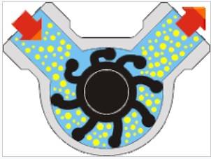

Try searching flexible impeller pump. This image of that pump is from the Wikipedia article:
Following some of the links leads to this quote: Solid Handling capability – solids can be handled with ease, but also without damage. Seeds, grapes and fruit in suspension can be handled gently, retaining solid integrity. It is favoured in the brewing industry as not only does it pump gently, but it can handle solids. Solids are also kept in suspension which can be important with textured products, such as; yogurts, drinks, or sauces. The quote is from this site: https://www.northridgepumps.com/article-141_flexible-impeller-pump-guide. If this type of pump can pump grapes, it certainly can pump glass spheres. Since it is a positive displacement pump, it can run as slow as needed to get the effect you want.
