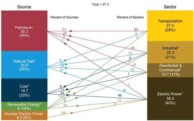

It is a very complex issue with lots of factets, including modifying life-style.. IMO looking at just electric without considering all energy is misleading. So are other artificial partitions that limit the discussion to one facet at a time. All the facets are interlinked. I won't call that obfuscation, but those barriers do mislead. IMO, only an all-inclusive debate on all facets of energy production and consumption is fair. Informing the voters about the issues would take on the order of one year of graduate school for each voter.
I am thinking of the broader picture
Edit: source of the picture https://www.eia.gov/energyexplained/images/charts/consumption-by-source-and-sector.png
Now imagine the upheaval if we make one small tweak. We shift most of that transportation sector consumption to the electric sector because of EVs.
I definitely agree as part of the broader issue. A low-carbon future will require changing how we use energy, not just how we produce it. Certain aspects of that are relatively easy (the "heating" part of HVAC, short range land transportation in cars and trucks) and other parts will be extremely difficult (planes and ships). That's part of why IMO nuclear power is so important; because converting fuel fired heat and short range transportation to electrical means we need to produce a lot more electricity. So countries that are talking about curtailing nuclear while still saying they want to be clean are just plain being stupid IMO. They are moving in the wrong direction.
