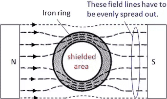

So when you are thinking about magnetic shielding scenarios, it's important to remember that the principle being used is that magnetic B-fields are diverted to higher ##\mu## regions (like inside ferrous metals or high-mu shields). So nothing magical is going on; you are just designing your "shield" geometry to intercept and divert B-field lines to guide them around your region of space that you want to keep free of that B-field.
So your ferrous cylinder can help to "shield" the inner region from external B-fields (assuming that the ferrous shield material is not saturated by the strength of the external B-field). But it will do very little to "shield" the B-field from a magnetic inside the cylinder, other than to attract and guide the B-field. So the position of the magnet inside the cylinder compared to where you want to "shield" would be important.

In this case the diagram is not correct however bevause the magnet is aligned with the axis of the cylinder.
I think the magnet inside the cylinder in the OP's scenario is likely meant to be aligned with the cylinder's axis, true. So those field lines would be pretty different, but still attracted to the high-mu material of the cylinder. The figure I posted was meant to be a general illustration for how B-field lines are deflected into regions of higher ##\mu##.
