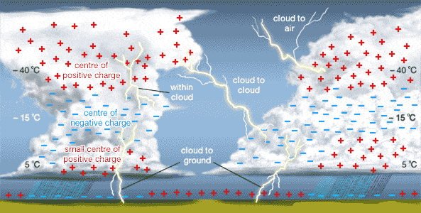

when the electric field exceeds the breakdown voltage of the gap, a lightning discharge occurs. There is no difference to this occurring be it with /between areas of the cloud and between the cloud and ground.Dave
here's a few pictorial examples ...
http://icons-ak.wxug.com/i/severe/lightning_explainer.png
cheers
Dave

my previous comments and the images clearly show where they go
Edison Bias said:
Why not just recombine?
recombine with what, they have become greatly separated over many kilometres as shown in the images ... between clouds and ground or between different regions in the clouds

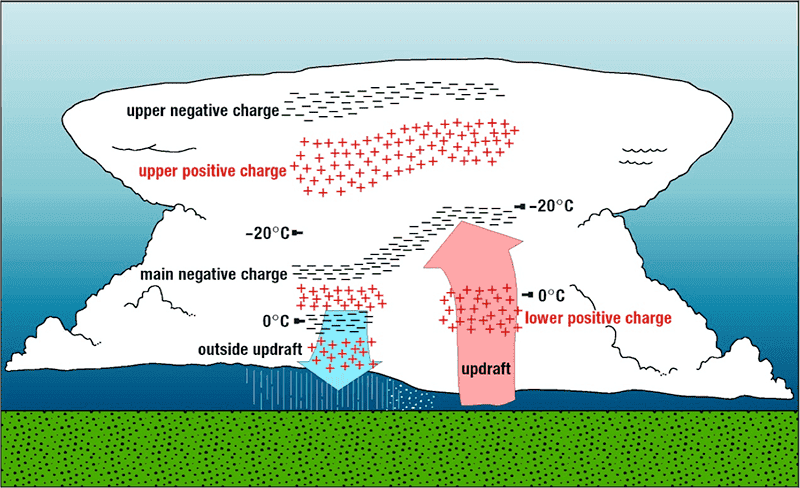

The charge separation can only occur when there is good updraught within the storm cell. As the updraught strength diminishes, so does the charge separation
Dave
I think this is the explanation I was looking for. Because how can charges of equal sign otherwise accumulate? It is even hard to understand how rubbing your feet on a carpet can strip and accumulate electrons within your body and then just discharge when you touch a doorknob of metal which even only may be sitting in a wooden door, that is the electric discharge does not even have to have a low ohmic path to the ground. It even feels like the discharge happens because the doorknob is made of metal without other considerations. As if metal itself accepts a bundle of electrons or even crave for it ;)
