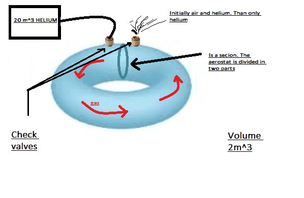

see the imagine... is ok ?

They will mix, there is nothing you can do against it.
With that geometry, the flow rate should not matter at all.
To have a good result, i think that this operation i need to do it, with the aerostat in vertical position e not horizontal position.
The orientation does not matter. The different weight is completely irrelevant compared to perturbations from flow and even compared to diffusion.
