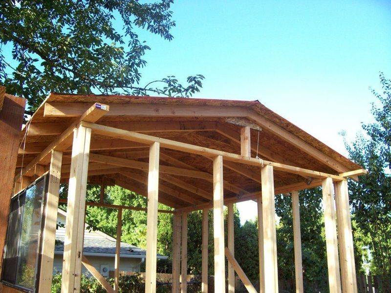

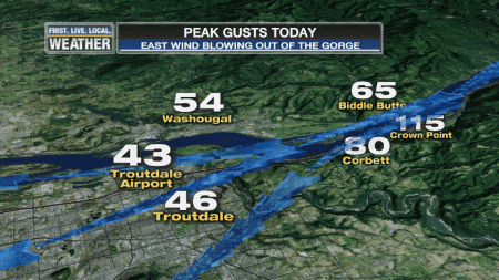

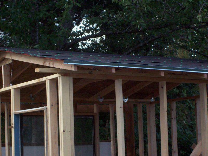

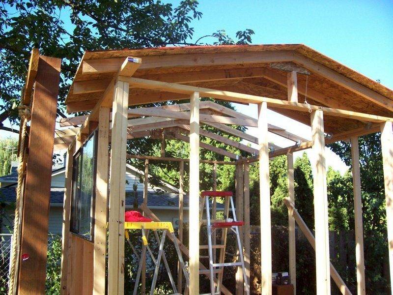

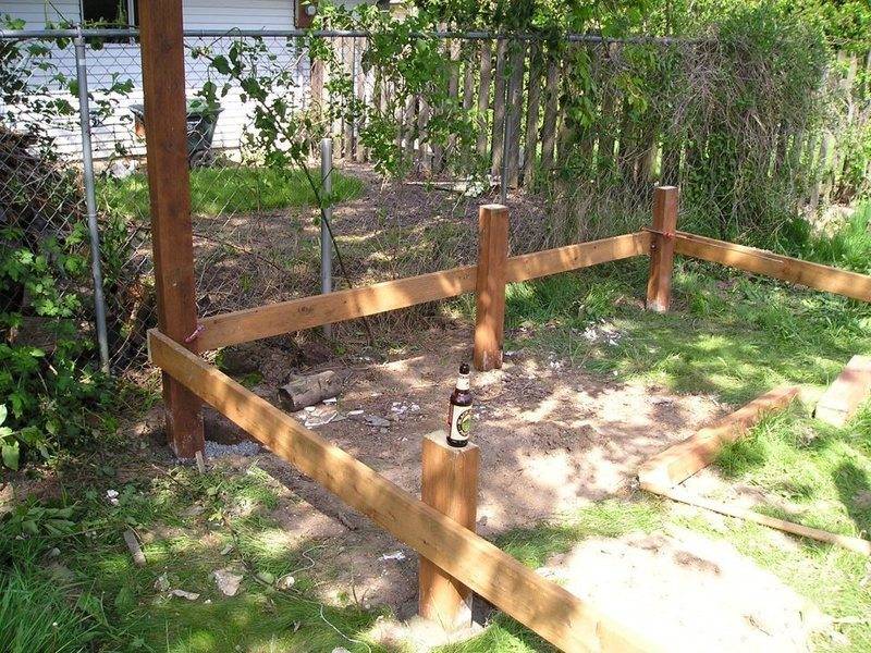

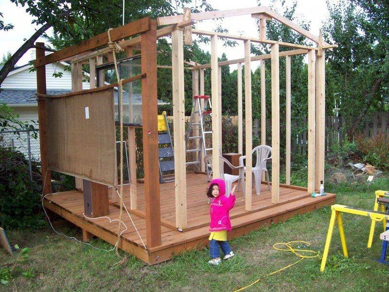

I live in the Columbia River Gorge wind zone so that was a concern for my shed project that I easily solved with hurricane ties and PL Premium (don't use it for anything that you might EVER have to take apart:-p) from the local hardware store.
Typical winter winds.
A simple knowledge of good construction techniques is all that's needed today because an engineer designed retail parts to handle the required wind loads.
https://www.strongtie.com/rooftruss...straps_coldformedsteelconstruction/h_ties/p/h
http://www.loctiteproducts.com/p/pl_ca_prem/overview/Loctite-PL-Premium-Polyurethane-Construction-Adhesive.htm
You can see the ties in this roof detail photo.
Likes BillTre, Psinter and tionis

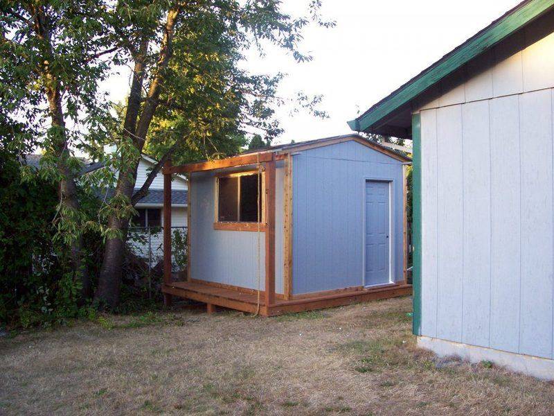

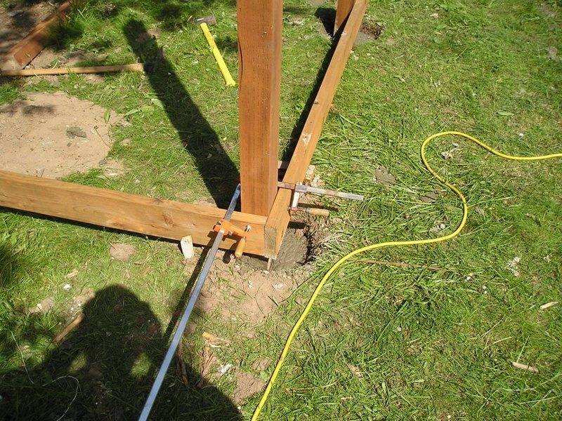

Now it won't be taken down by the wind. But did you calculate whether it can be taken down by a truck and took protective measurements against it?
The deck would take a pretty good knock to bring it down. It's build on a slight slope so I dug some nice deep holes to anchor it with concrete so I think it could handle a 'small' truck. o0)
It's over engineered for a simple shed but that's part of the fun of building stuff.
