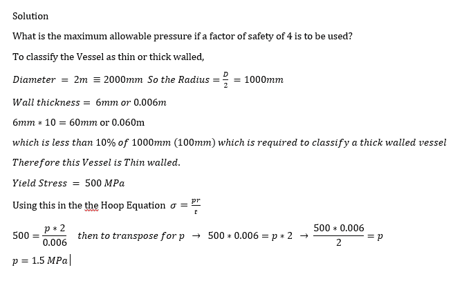

Q6. A cylindrical vessel 2m internal diameter and 4m long has a wall thickness of 6mm. Strain gauges are installed on the vessel to measure hoop strain (see FIG 6).
The Young's Modulus of the Material = 290 GN m^-2
The Yield Stress of the Material = 500 MPa
The Questions are
(i) What is the maximum allowable pressure if a factor of safety of 4 is to be used?
(ii) What pressure would a strain of 40με indicate?

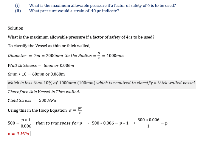

For (i) I get:
Does this look correct?
for part 2, I cannot find the relevant equation to suit the pressure vessel. I have the hoop equation as
σ = pr/t
Where:
p = Pressure
r = radius of the vessel at 1000mm
t = Thickness of the vessel at 6mm
I am aware the strain is represented as a change in length by 0.000040 but I am not sure how to use this in my working out, given the fact I haven't used the Young's modulus of 290 GN m^-2 either.
Can anyone help me with this question?
(i) No. As your hoop equation indicates, the hoop stress is not equal to the pressure. What pressure would give a hoop stress of 500 MPa?

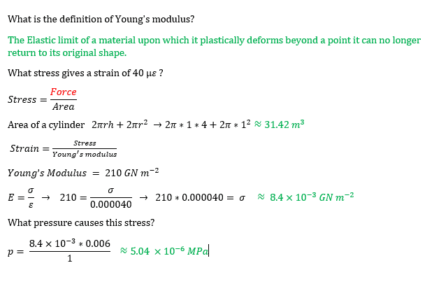

(ii) What is the definition of Young's modulus? What stress gives a strain of 40 ##\mu \epsilon## ? What pressure causes this stress?
Ok for part (i) This is what I have come up with?
Does this look ok?

On the right lines, but the radius isn't 2, is it?
So what is the max allowable pressure?
No it isn't you are right, So with a correct radius of 1meter the answer gives 3 MPa. If I follow my original post method that the maximum allowable pressure is 1/4 of this I would get 0.75 MPa or 750000 Pa

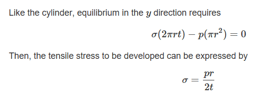

How does the axial stress affect the hoop strain?
I think the axial stress is twice the hoop stress therefore twice the hoop strain?

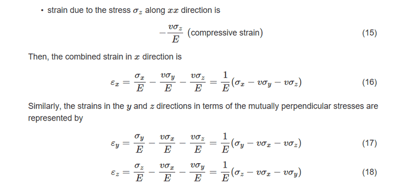

What is the exact equation for the hoop strain as a function of the combination of the hoop stress and the axial stress.
Would this be the relevant equation I am looking for?
No. You need Hooke's law in 3D for conditions of plane stress. Google key words Hooke's Law plane stress.

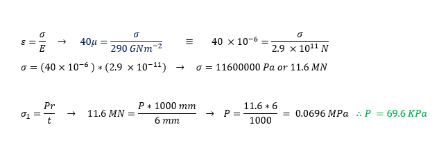

I have followed the guidelines in the lessons and obtained this figure for pressure?
If this answer is still wrong I will pursue the Hookes law in 3D method although it is not in the methods provided to me through the University.
Thanks

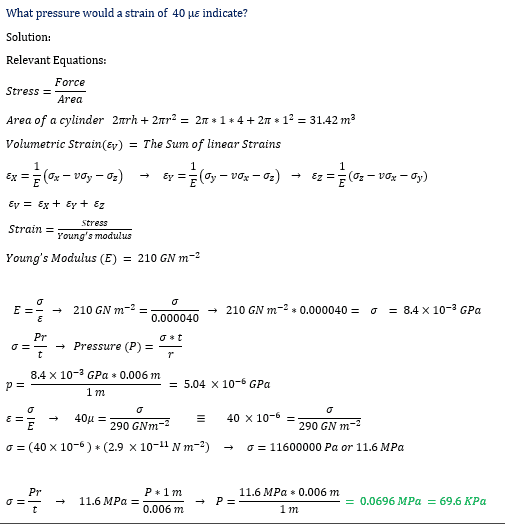

For This part question I have spent some time going back through my lessons provided and found this:
does this look like the correct method to follow in obtaining the pressure value which would cause a strain of 40μ?
This is the last question in my assignment and I am determined to get the highest possible marks. Anyone who can offer help please do.
Thanks
Yes. But, of course, you need to use the corresponding equations involving the stresses and strains in cylindrical coordinates. And don't forget that the stress in the radial direction is much much smaller than the stresses in the axial- and hoop directions, and should thus be taken as zero.

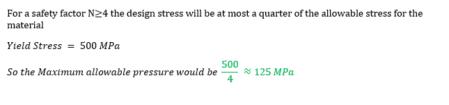

Just to Check, Is part (i) ok now or should I be dividing by 4 for the safety factor? I think I should divide my answer by 4 to get 0.75 MPa maximum allowed pressure?
It depends on how they are defining the yield stress.
I can only attempt my answer from the information provided in the initial question. It says the yield stress of the material is 500MPa?
When it mentions the safety factor of 4 I am sure I need to divide the final pressure by 4 to get my result. I just needed a verification I was doing the correct thing?

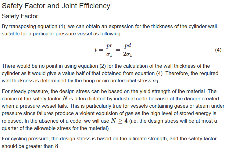

Thank for providing that link, it was very helpful. According to the information given in the link with regards to Anisotropic yield, This occurs when a metal is subjected to large plastic deformations. As the question states 'What is the maximum allowable pressure if a factor of safety of 4 is to be used?' It doesn't reach the large plastic deformation to use the Anisotropic yield criteria which rules out the use of the von Mises yield criterion. I have copied the details of this link at the bottom of this thread.

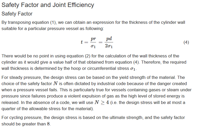

So from my lessons on this subject:
So I have the wall Thickness = 6 mm or 0.006 m
The Radius = 1000 mm or 1 m
And the Yeild Stress = 500 MPa
Inuptting these known figures into the above equation and transposing for (P) I have an answer. P = 3 MPa.
In the lesson notes It mentions ' In the absence of a code, we will use N > 4 (i.e the design stress will be at most a quater of the allowable stress for the material.)'
Well the yeild stress is 500 MPa and the pressure I have worked out to be 3 MPa. So if a 3 MPa pressure would cause a yeild of 500 MPa then a safety factor of 4 would require me to divide this firgure by 4 giving Pressure = 0.75 to create a yeild of 125 MPa?
Does this look like it could be a correct answer or am I missing something? from my previous questions, my history would suggest I am missing something.

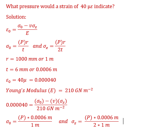

Also, This is what I have obtained as a final answer to part b?
with the 3dimentional method I would need the poissons ratio and also I came up against a complication in measuring the x and y stresses when they would be acting on the rounded edges of the cylinder? what surface area would I use in the equation provided stress = force/ cross sectional area?
I have gone with what I think is the correct method. Can anyone verify this?

You are not interpreting it correctly. The von Mises yield criterion is fine for determining the onset of yield even for small deformations.
OK. So they are indicating that you should use the maximum principal stress criterion to establish the yield point.
Correct
No. The yield stress is a property of the material, and is independent of the loading. At 125 MPa, the material will not yield.

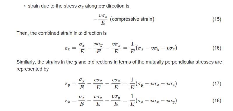

No. This is not done correctly. The strain in the hoop direction is given by: $$\epsilon_{\theta}=\frac{\sigma_{\theta}-\nu \sigma_z}{E}$$where $$\sigma_{\theta}=\frac{pr}{t}$$ and $$\sigma_z=\frac{pr}{2t}$$
Likes Al_Pa_Cone

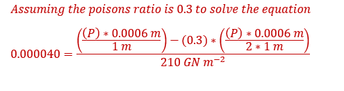

With this method, I am left with 3 unknown values in the first equation and 2 unknown values in the sub equations.
If don't have the value for Stress in each of the two how can I get a value for pressure? and also the poissons ratio is still unknown in the first equation?
This Is my last assignment question and I was really hoping I had completed it as I have spent weeks on this one! I don't know where to start with this one then.
Al_Pa_Cone said:
With this method, I am left with 3 unknown values in the first equation and 2 unknown values in the sub equations.View attachment 111346
You solve the strain equation, treating the pressure P as an unknown. This can't be done properly without knowing the Poisson ratio. Assume a typical value of 0.3.

Wow! how am I supposed to transpose that for P? I am not to bad at transposition but that looks a nightmare!
In first year (9th grade) algebra, we learned how to solve a linear algebraic equation in one unknown. Apply what you learned there.

I am truly very sorry. No excuse. I won't let that happen again. Here's what you get when you factor the right hand side of the equation (and correct a few arithmetic errors and typos):
$$0.00004=\left[\frac{\frac{1}{0.006}-0.3\frac{1}{(2)(0.006)}}{210000\ MPa}\right]P$$
Is the Young's modulus 210 GPa or 290 GPa (as in post #1)?

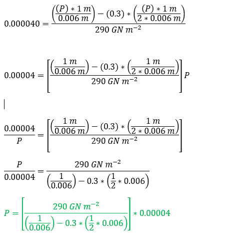

  • #33
I haven't taken any offence by your previous comments but thanks for accepting, it wasnt a helpful reply.
I had noticed the 0.0006 typo when it should have been 0.006 but I missed the 210! good spot. I find transposition very interesting and I like to try and solve these problems myself by substituting unknown values with simple numbers to see what works and what is acceptable. The factorising part was a little more advanced to the basic transposition as I couldn't figure out how to get both values of P into 1 P. I will look back over my maths bridging course and try to refresh my memory on how to achieve it.
Thanks for the help!
  • #34
Does This look ok?
  • #35
Sorry there was a problem with my answer when I didnt use a bracket when typing in 2*0.006 so it seperated.
This is my answer?
