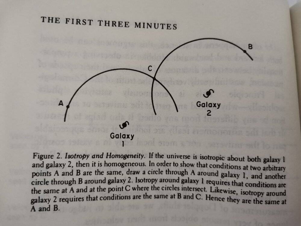

As you said, we can observe that universe looks isotropic from our perspective. Now if you accept that there is nothing special about our place in the universe and that it also looks isotropic from other places, you can say that universe is homogeneous.
I like this illustration taken from Weinberg's "The First Three Minutes", explaining why the universe is homogeneous when it is isotropic:
Likes Phys12

Isotropy around any point in the universe, such as your navel, combined with the Copernican principle, implies isotropy around every point in the universe; and isotropy around every point in the universe does imply homogeneity
It's from Barbara Ryden's book, by the way, on intro to cosmology.
Likes lomidrevo
