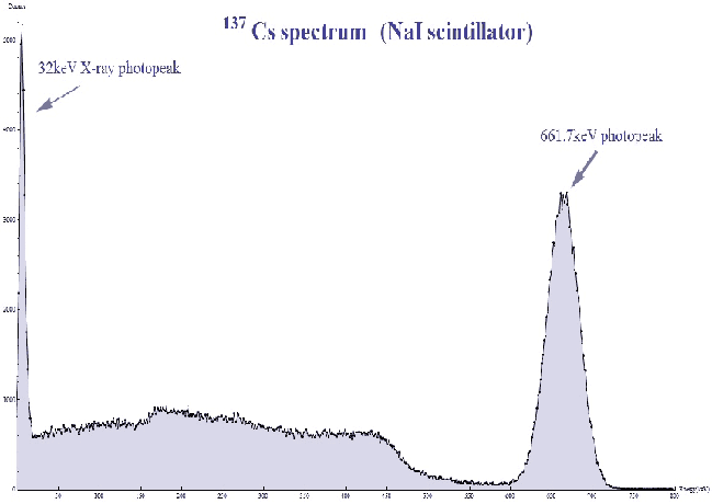

Hello everyone. Is there a type of radiation detector that can tell the energy level? I have a basic understanding about Geiger counter and Scintillation counter, they seem only tell the incident particle number.
The testing environment may contain Thorium series, Uranium series and Actinium series decay chain. The purpose is trying to find out what particles are there, or at least what decay (energy level) is in there mainly. Please let me know what kind of radiation detectors suits most. Thank you!

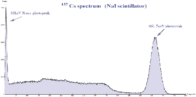

The radiation interacts with the scintillation material (SM) via all possible EM interactions with the Compton effect dominating exciting the atoms in the SM with a subsequent emission of some light. The SM must be transparent to this light to allow it to be collected by the photo multiplier tube (PMT). The light photons entering the PMT cause the emission of electrons from a photo cathode the number of which depends on the intensity of that light which in turn depends on the energy deposited in the SM. The PMT amplifies the charge liberated by its photo cathode to produce a usable signal for further electronic processing. The signal strength depends on the energy deposited in the SM. Below is a typical pulse height spectra of a single gamma ray
Characteristically it has a peak representative of the total energy deposited in the SM called the photopeak along with a fairly uniform tail extending to the lowest pulse height representing whose processes that only leave a part of the radiation energy in the SM. This tail is primarily due to the Compton effect and the subsequent degrading of the energy of those electrons released.
In a spectrum of a more complex decay you will see many photopeaks with their accompanying Compton tails superimposed. The full width at half max of the peak is typically about 8% of the pulse height. It can be challenging to analyze these spectra.
Efficiencies of scintillation detectors are typically 2 to 50 % depending on energy, detector size and source detector distance.
