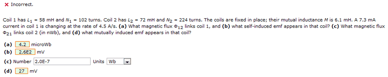

I now know the units are nWb. I'm just getting a little confused by answer.
((6.1mH)(7.3mA))/224turnes=.198795) (mH*mA)/turnes
So would that equal= 198.795 nWb?
Why are you dividing by the number of turns? From the definition of mutual inductance,
$$M = \frac{\Phi_2}{I_1}$$
