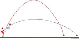

However, the 45 degree take-off angle is optimised for longest possible horizontal travel distance to the same vertical position as at take-off. So you really want to make sure that your take-off point is as low as possible, because then you can convert maximum GPE into kinetic energy AND then catch the ball at the same height.
It makes no sense to say the angle must be 45 degrees if your launch point is 10cm higher on the table than your catch point. If you superimpose two parabola trajectories with the same initial speed but different initial angles, and the take-off point is at y=0, then the 45 degree parabola will intersect the y=0 line a second time at maximum x value. However, it will NOT necessarily intersect the y = -1 line at maximum x value... a slightly smaller angle will.
Hence if your take-off position is 5cm above the table, because you used a very large ramp, the 45 degree condition is not optimal. You could get more distance by (a) using a smaller take-off angle and positioning your catcher at a lower height, or (b) by using a smaller ramp, to attain more kinetic energy, and positioning your catcher level with the take-off (using 45 degrees).
Conclusion- there is definitely some maths to be done!
This image might help explain what I mean- the smaller take-off angle attains greater horizontal distance if the particle falls below take-off height.
There's no benefit in making the take-off point lower if the catch point remains the same height. In fact, you'd be worse off because it would increase losses. I'm assuming the vertical difference between the start of descent and the catch point is a given.
You're quite right, thanks for picking that up. I was making the unwarranted assumption that the take-off point and catch point were at the same height. There are standard equations for the more general case, which back in school was called "range on an inclined plane". See e.g. "Maximum range" at http://cnx.org/content/m14614/latest/
If the vertical difference between starting point and catching point is fixed and we neglect losses, the optimal launching height is "as low as possible" with a very steep angle - this is easy to see with a time-reversed setup.
With losses, launch height ≈ catch height looks like a reasonable setup.
