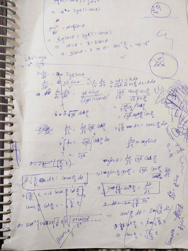

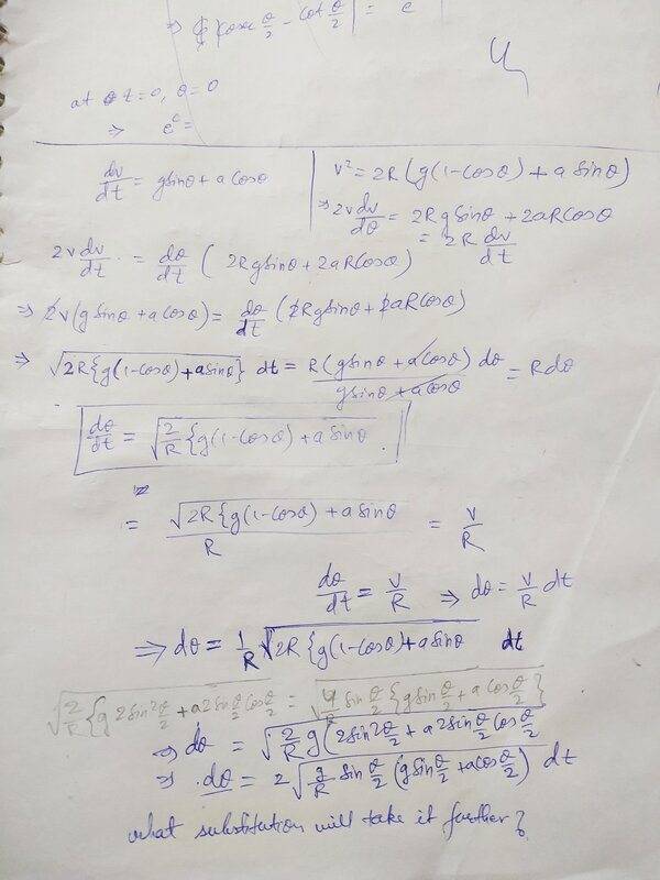

These are the all pages on which I made attempt to solve this question from start to finish, apparently I couldn't finish it. Most of it will seem like illegible on first sight, but it isn't illegible to me. On the 3rd page, at the bottom, where I had written with pencil first, but then felt like it wouldn't be legible as I was taking pic where lighting condition were not proper, I rewrote the last 2 lines with pen. After I figured the differential equation that I had also posted in the beginning of the topic, I made the substitution ##1-cos\theta = 2sin^2\frac{\theta }{2}##, but after that, still couldn't make it work further. That's when I posted it on this forum with the title" What substitution/other method to use to solve this differential equation?" I was only interested in the substitution that might have worked.
You can make all the judgement in the world about my capacity/incapacity to make it work after substituting ##1-cos\theta = 2sin^2\frac{\theta }{2}##, but that's what i honestly put in the description of the post that, at this point it is more of a math problem instead of being a physics problem. I also wrote in comment # 11, that I tried substituting, but couldn't make a dent. That didn't mean that a dent couldn't be made by someone else.

Set the forum aside for a moment and think if physics is for you. If it is, there is a point in writing further. I will try one more time to show you what I expected. You have the equation$$\frac{d\theta}{dt}=\sqrt{\frac{2g}{R}(1-\cos\theta)}.$$
You make the substitution to get$$\frac{d\theta}{dt}=\sqrt{\frac{2g}{R}2\sin^2(\theta/2)}.$$What do you think comes next? Hint: separate variables.
Please show your work starting from what I gave you.
