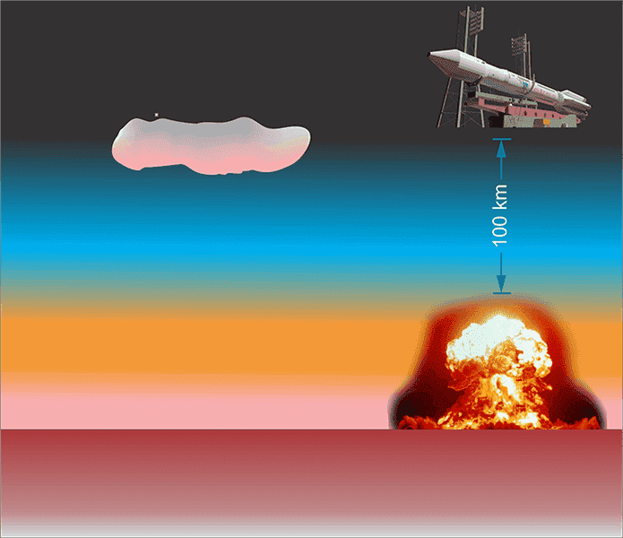

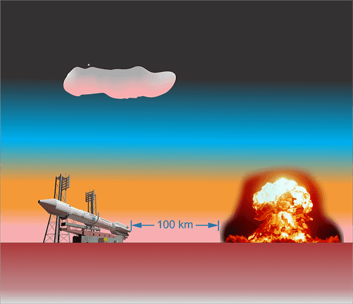

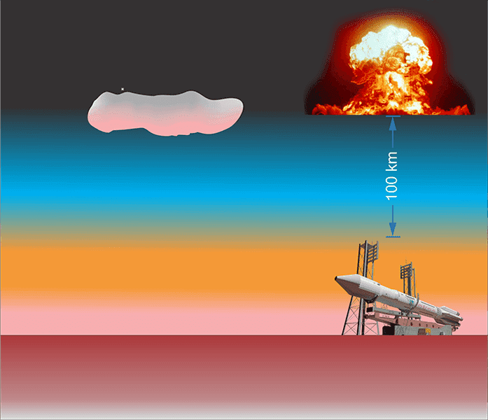

When the powerful (nuclear) bomb explodes it generates the shock wave that destroys everything around it. I want to know, does the force of this shock wave depend on the air pressure and density? Imagine that we have got powerful (nuclear) bomb and the object (rocket in this case) that is subjected to this explosion. In all three cases the distance between the bomb and object/rocket is the same-100 km. But there is one difference:
1) In first case both bomb and rocket are placed on the Earth’s surface, so the atmosphere’s (where the shock wave propagates) density and pressure is constant:
2) In the second case the bomb is on the Earth’s surface and rocket is on the 100 km altitude. So, bomb’s shock wave will be spread in relatively dense medium and then in rarified one.
3) In the third case the bomb is on the 100 km altitude and rocket is on the Earth’s surface. So, bomb’s shock wave will be spread in relatively rarified medium and then in dense one.
So, my question is: in which case the bomb’s destructive force will be more powerful? Or there will be no difference? :rolleyes:

The first image, where the object is at the same level as the blast and is in the densest air, will be the most effective.
In the other two examples the blast travels through a less dense medium, which will cause a higher amount of 'damping' of the wave.

I do not think it is correct to say that the denser the environment is, the greater the damage.
The following factors are in play.
1. Immediately after explosion, most of the energy is in radiation - X-ray radiation. If the medium is very "thin", most of it will just escape without attributing its energy to the shock wave. So denser medium converts more energy into the shock wave. Very high altitude nuclear explosions are known to be very different from surface or low altitude explosions, their primary effects are production of ionization and electromagnetic pulses.
2. When the shock wave propagates, it deposits part of its energy in the medium. The denser the medium is, the more energy it absorbs. The intensity of the shock wave is thus inversely proportional to the cube of the distance - if the medium is homogeneous.
3. If the explosion is close to the ground, the shock wave is reflected from the ground and it combines with the primary shock wave, causing more damage. If I remember correctly, for every yield there is a sweet-spot burst height that maximizes the "total destruction" radius.

I understand this, but I wanted to know what the difference between second and third cases is :rolleyes:
voko
So, the second case will generate more powerful damage from shock wave, right?

In theory, yes. In practice, though, the distance must be very large (100 km and more) to have a significant difference in the character of the explosion. The shock wave from a typical blast won't reach that far.
Wov, this is absolutely opposite to what you have just written:
These two effects contradict to each other, which one will prevail? :rolleyes:
As usual in such cases, the curve for the "radius of total destruction" goes up and then down as the density changes. Where exactly the maximum is, I am not qualified to say. If I were, I would probably not be permitted to, anyway :)
Heh, actually you simply asked if case 1, 2 or 3 had a more destructive shockwave.
The question of the difference between the second and third cases is quite interesting.
And, come to think of it, I'd like to argue that the first case is still the most effective, when considering the three given scenarios.
I know that Voko made the point that there is a certain altitude for a detonation that allows the wave to reflect off the ground and cause maximum destruction. But that won't be so high up that the air density is any different to that of the air at ground level.
So when considering the three extremes presented in those image, where the density of the air above the ground is much less (since this is what was original question asked about), I would still say that case 1 is the most effective, because the detonation slightly above ground where the wave reflects, is still under conditions best represented by case 1.
(Remember we're thinking about shock/pressure waves here - not the EM radiation - a shock wave from a v.high less dense altitude is simply not going to propagate quite as well, because it has less of a medium to propagate through)
