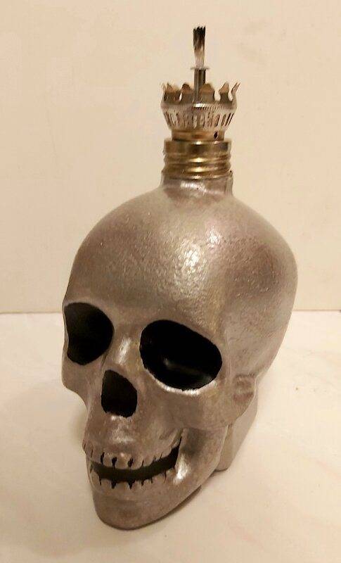

Homework Statement:: Oil Lamp ( Paraffin help )
Relevant Equations:: Not sure what to write here
HI folks,
I'm trying to make an oil lamp from an old Vodka bottle.
The bottle is the usual 750ml and is in a skull shape bottle. ( maybe you know it )
Anyhow I have all the materials and almost ready to go but, I don't want
750ml or anything close to that number of lamp oil ( Paraffin of sorts ) in the bottle as
it may have a deadly consequences.
So my question to you all is what kind of liquid or substance can I put in the glass bottle
to fill it up ( that maybe hardens ) that can fill the bottle maybe half way so as not to have to put in so much
Paraffin. Also it would have to not react with the paraffin as I'd hate to have slight amounts of
say...Resin, or glue burning off with the oil.
Anybody know of a good solution?
thanks
Dan in Toronto

Hi folks. Thanks you so much for you help. I will try here to attach a picture of the lamp so far. Again it's a pretty thick old Vodka bottle with it's neck shaved off and Chimney glued on. I think the ball bearings or marbles idea might be the winner as it'd keep the wick from from mixing with water.

Holy smokes! That's a vodka bottle? :woot:
Hey Berkeman,
Yes it's actually Dan Akroyd's Vodka company from Nova Scotia
Likes BillTre
Mind you I primed and painted it of course. It originally is clear .
Likes BillTre
Daniel Lee said:
Hey Berkeman,
Kinda looks like Dan after one of our parties. He used to frequent the PF Mentor lounge. Hoo-boy, those were the days...

You might try a test tube insert. A little fiddly but sounds like just what you need.
Likes hmmm27
anorlunda said:
This simply amazing. The oil seeps slowly inside and everything drowns...:))
Likes 256bits
Sand will work. Add a bit of glue if you want it to stay in place.
Glass fibre resin - be careful - it gets hot when setting.
Potting compound/resin.
Mortar.
Molten lead - don't breathe any fumes as they are extremely toxic. Don't use if it will damage the skull.
Bore a hole in the base and insert a glass bottle for the oil and glue it in place.
