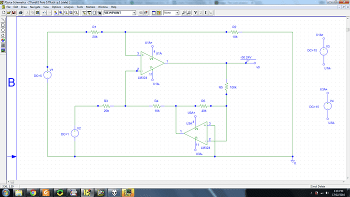

When analyzing this following circuit in PSpice, changing the power supply to the LM324's (even between 3 and 30) drastically changes the output voltages.
imgur link:
The top op amp has no feedback loop, so I figure its power supply should be higher than 5V to get to a saturation response.

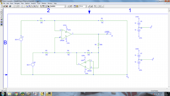

This is my circuit in PSpice as drawn up in PSpice with some values shown next to Voltage sources.
imgur link: http://i.imgur.com/1h76t3y.png
According to the text, v0 should be -4.992V.
Now, if I take those op amp power supplies both to 30V, v0 becomes -5.005V...much closer to the text answer. Increasing op amp power supply beyond 30V causes no further changes, it seems to max out at -5.005V.

First off, both op amps have feedback. They share components in their feedback loops, that's all.
As to what power supply you should use with an op amp the first place to start is with the datasheet for the op amp. That will tell you what values of supply it will accommodate. Then you can choose the supplies based on the dynamic range you need in the circuit. You want to be sure that all the op amps stay within their linear regions (usually some fraction of the supply voltage) under all conditions.
The LM324 can handle 32V between its rails. Since the "text answer" is negative, the textbook is assuming split rails. Try VCC = 15V and VSS = -15V (instead of 0V) and see what happens.

It didn't change the result by much :P

Well, actually, the output voltage changed an order of magnitude when I halved the voltage at the power supply. What didn't change the output much was switching the power terminals on the op amp from (+30 to 0) to (15 to -15).

Just using calculations and ignoring the power supply values at first, what do you get for the input and output voltages of the opamps in your first schematic?
Then you just need to ensure that your power supplies for the opamps are wide enough to stay away from those input and output voltages. As pointed out, you can refer to the LM324 datasheet to see what the input and output voltage ranges are with respect to the power supply voltages. :smile:

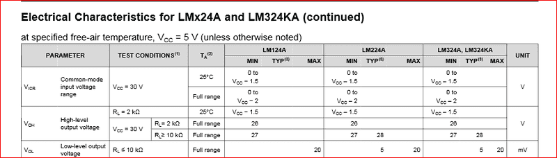

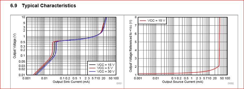

LM324 can drive its output to within ~1.5 volts of positive supply, so V+ needs to be at least that much above most positive output you'll need.
LM324 can drive its output to negative supply but only at low current, so give it a volt or so "headroom" there, too . Make V- a volt or so more negative than most negative output. In a pinch you could get away with less negative side headroom provided the opamp only has to accept a few microamps into its output pin. See chart beow.
LM324 has similar headroom requirements on its inputs. That's why you have to consider both input and output.
From LM324 datasheet
Spend some time with datasheets they're a wealth of practical information
