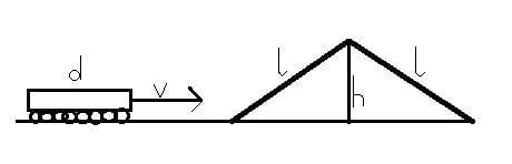

There is a train of length d and speed v. It is heading towards a hill with height h and length of each side l. What velocity requirement must be met so that the train can go up and down the hill?
Ek=m⋅v2/2
Ep=m⋅g⋅h
I'm basically stuck at conversation of energy. Train needs to have kintetic energy equivalent to potential energy mgh, but calculating v from this equation seems pointless since it doesn't include either length. I have no idea how to include either of them.

According to the image it would be hanging there unless the top is flat for a distance equal to the length of the train. I don't really see any other option of train's movement, so i'd say that the centre of mass is going to be on top of the hill.
Is that your drawing or a drawing supplied with the problem?
Note that a train typically is quite flexible (at least in the connections between wagons).
This is the drawing supplied by my teacher. So this train bends and takes shape of the hill while it's on the top?
Yes. Consider the parts of the train on the uphill and downhill sides separately. You can find the mass centre of each part easily. What does it tell you about the location of the mass centre of the whole train?

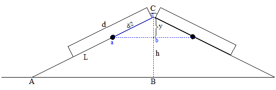

See my recommendation in post #18. And here's a diagram that may clarify discussion:

So yeah, the answer i got is v > sqrt(g⋅h(2-d/2l) from similar triangles and their ratios. New height on which the center of mass is, is h((hl-d)/4l) so then we plug it as height in equation mv2/2 > mgh and rearrange it to get velocity.
