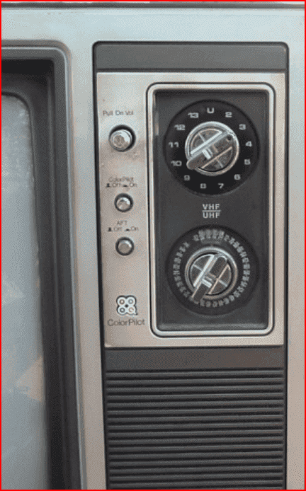

- I had an old dial tune TV set. Obsolete now.
It had a small button that I think was suppose to improve reception. What did that button do physically?
Button or dial? It was common to have a "fine tune" dial control on those early sets, since they did not have frequency synthesizers and other ways of making very accurate frequency adjustments.homerwho said:Summary: I had an old dial tune TV set. Obsolete now.
Dial. It had a button that when pressed it would latch. It did have the fine tune knobsberkeman said:Button or dial? It was common to have a "fine tune" dial control on those early sets, since they did not have frequency synthesizers and other ways of making very accurate frequency adjustments.

A picture would help.homerwho said:But it had a three position push button.
A quick Google Images search on Panasonic TV 1980s turns up some possibilities. Here is the CT9010, which does indeed have an AFT button...homerwho said:It was a Panasonic from the 80's.
That's my bad. The link was kind of hidden at the end of my post after the picture.homerwho said:I didn't see the Wiki link.
That is my impression, although I've never designed that particular kind of circuit (I've designed PLLs, which are a related type of circuit though).homerwho said:Is it a tracking function of some kind?
Wikipedia said:In radio equipment, Automatic Frequency Control (AFC), also called Automatic Fine Tuning (AFT), is a method or circuit to automatically keep a resonant circuit tuned to the frequency of an incoming radio signal. It is primarily used in radio receivers to keep the receiver tuned to the frequency of the desired station.
And maybe this is why it didn't seem to do much. If you try to use it to improve the picture right away, that's not what it was for. It was to keep the picture tuned well as you watched the same channel for a while (especially right after you turned the TV on and the tuner circuit wasn't warmed up yet).homerwho said:It never did didly swat
berkeman said:That is my impression, although I've never designed that particular kind of circuit (I've designed PLLs, which are a related type of circuit though).
My impression from the Wikipedia article is that the feature is used to help stabilize the tuner's lock-in to a channel once is is tuned well. It helps to prevent drift of those old tuner circuits with temperature and time as you stay tuned to the same channel. So I'm guessing (somebody find the old manual please?) that you would change the channel knob to the channel you wanted, turn the Fine Tuning knob to get centered on the broadcast signal, and then turn on the AFT/AFC.
As long as the TV was still turned on, that would help to keep the TV tuned right on the frequency of that chosen channel. If you wanted to change channels or if you turned the TV off and later turned it back on, you would need to do the fine-tune knob (with AFC off) again first, and then re-engage AFC. But that's just my educated guess, unless somebody can remember better or find an old TV manual...
