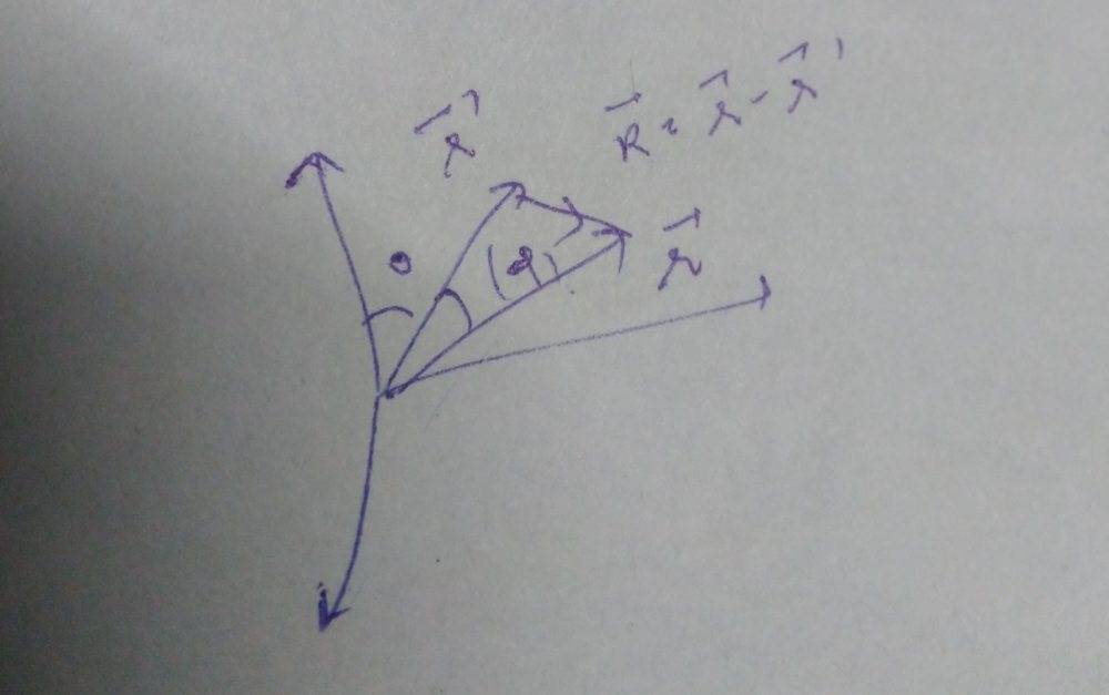

Okay I have made a schematic diagram
##\vec r## is fixed,##\vec R=\vec r-\vec r'##

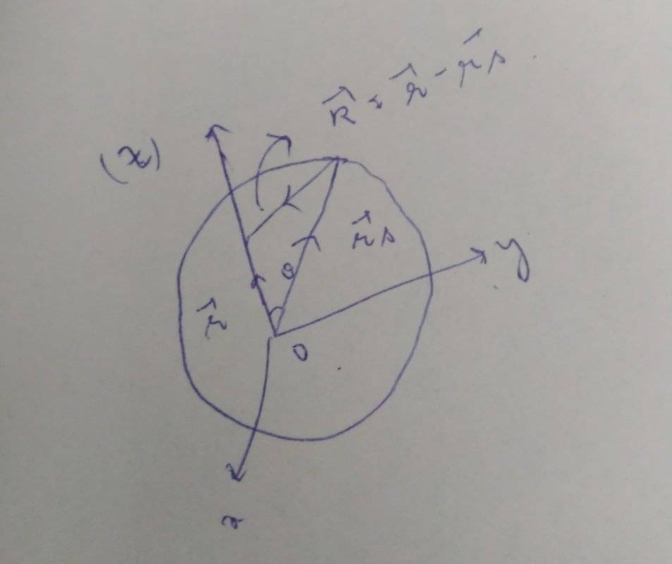

now ##\int_{v'}\vec \nabla_{r'}(1/R)dv'=\int_{s'}(1/R)\vec ds'## is done over a spherical surface having radius ##r_s## then it reduces to ##\int_{s'}\frac{1}{r_s^2+r^2-2rr_scos(\phi)}r_s^2sin\theta d\theta d\omega\hat r_s=2πr_s\int_{s'}\frac{1}{r_s^2+r^2-2rr_scos(\phi)}sin\theta d\theta(\vec r-\vec R) ## where ##\omega## is the azimuth 0 to 2π ,##\theta=0## to ##\pi##.
Can anyone will give any hints how to deal with such type of integrals??
Note:within the integral ##\vec R=\vec r-\vec r_s## has it's tail at the surface of the sphere
This is similar to the integration in the shell theorem, which you may have encountered. E.g:
http://hyperphysics.phy-astr.gsu.edu/hbase/Mechanics/sphshell.html#wtls
@PeroK
Okk ,then in that case the integral reduces to
##\int_{s'}\frac{1}{r_s^2+r^2-2rr_scos(\theta)}r_s^2sin\theta d\theta d\omega\hat r_s=2πr_s\int_{s'}\frac{1}{r_s^2+r^2-2rr_scos(\theta)}sin\theta d\theta(\vec r-\vec R)=4\pi\vec r-\int_s2\pi r_s\frac{\vec R}{r_s^2+r^2-2rr_scos(\theta)}sin\theta d\theta##
The problem here is within the integral there is ##\hat r_s## which is not constt. throughout the integration

The link I gave you shows a technique for tackling that.
PS if you have studied electromagnetism then a quick way is to find a charged sphere that generates the same integral for the electric field.
I understood this but the problem is how to tackle the unit vector ##\hat r_s## within the integral which is not constt. ,##r_s## is the radius of the sphere of integration
Our integration is ##\int_s(1/R)\vec ds=\int_s(1/R)r_s^2sin\theta d\theta d\phi \hat r_s,##
##R=√(r^2+r_s^2-2rr_scos\theta)##
##\hat r_s=(\vec r-\vec R)/r_s##
Putting these it reduces to ##2\pi r_s \int_s[\frac{\vec r}{R}-\hat R]sin\theta d\theta##
Now since ##\vec r## is constt. the first part is solvable but how to do the second part ??
