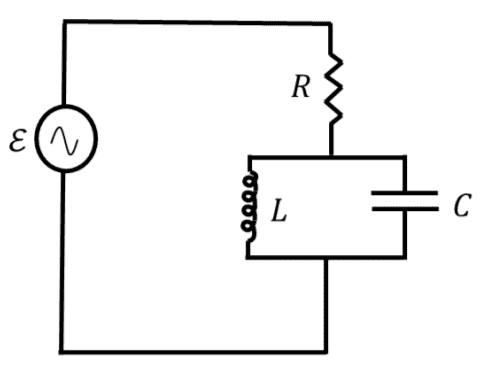

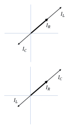

What will the phasor diagram of this LCR circuit looks like?
In summary, the current of capacitor and inductor must be parallel but pointing in opposite directions due to the fact that they are connected in parallel and have the same voltage. However, the direction of the current of the resistor is dependent on the frequency as Z is a complex number.
Cedric Chia
V=IZ
I know the current of capacitor and inductor must be parallel but pointing in opposite direction due to the fact they are connected in parallel thus having same voltage (please see attached screenshots). The current of resistor will simply be the sum of these two vectors, but what about its direction? Should it be pointing the same direction as the current of capacitor or inductor?

Hello CC,
Are you aware of the fact that Z is a complex number and that it is frequency dependent ?
Your statement
does not make much sense to me, nor does
since I always learned that current is a scalar -- but perhaps you mean something else ?
