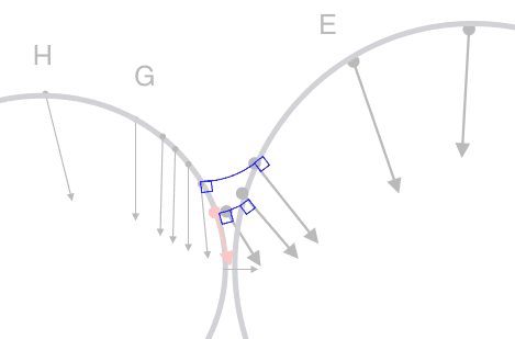

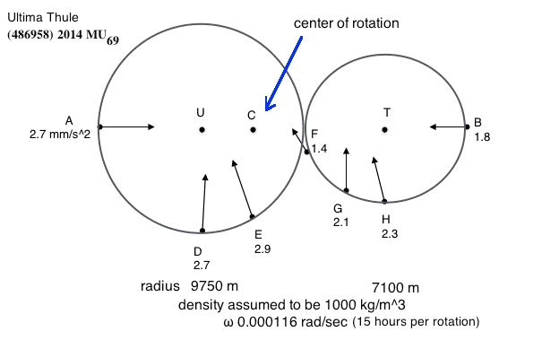

I did a rather simple analysis of gravity on Ultima Thule.
The only interesting area is between F & G.
Probably not habitable, being only 34 km from end to end. But fun to think about.
Likes BillTre
Cool. So starting at G, you'd be on the side of a hill, sloping sharply (feeling like about 45 degrees) down toward F.
As you "walked" (gently bounced) downhill, you'd feel the slope under your feet rapidly becoming vertical - more so than expected, until you'd just drift off in the direction of C, eventually bumping into the larger mass.
It would be interesting to visualize the walk from the stroller's POV. The apparent horizontal would not be where you expect.
Standing at H, it would feel like a 15 degree slope, and it would look like the horizon of the larger mass is directly horizontal to your line of sight (i.e. perpendicular to the direction of "down" for you at H.)
I wonder, if you stood at F, could you push the masses apart...
Likes BillTre and OmCheeto
I think you've got it.
Though Ultima Thule is kind of weird, as the surface gravity is 3600 times less than here on Earth. Probably feels effectively weightless.
Perhaps I'll make another spreadsheet, doing the same thing, by tying a rope to the moon, and pulling it to the Earth's surface.
Might work. Might not.
You never know, till you do the maths.

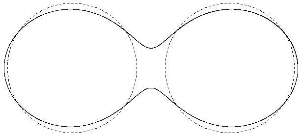

I don’t see how my claim proves the Roche Limit under this conditions. However, as that seems to be OK for you let’s start with it:
Two equal bodies with distance of 2.433·R would almost form a contact binary if they would remain spheres with radius R. But they don’t remain spheres due to tidal forces and centrifugal forces in the co-rotating system. Even with the conservative assumption that the mass is mainly concentrated in the centers the resulting deformations are sufficient to bridge the small gap between the original spheres. This is the result for two Earth-sized bodies (shown from the side):
As real or even homogeneous mass distributions would result in even larger deformations and therefore allow for contact binaries with a larger distance the Roche Limit actually supports my claim.

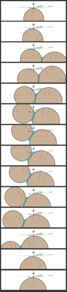

Here is what it would look like walking from pole to pole. Thanks to @OmCheeto for providing the template.
I'm not too happy with the water line. The water will always be horizontal, wherever he is in it.
But I think he falls straight down into it from the left, whereas he is able to walk out of the surf on the right.
Bah. Too small to see.
Here it is in all its glory.
It'd be cool to zoom in on just the waist, but I'd need Omcheeto to add a few more vectors.
Likes Richard Crane and BillTre

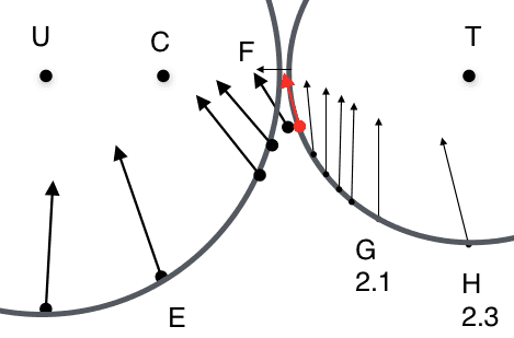

Like this?
I made the one arrow red, as it was almost invisible resting on the surface of Thule.
I've only found a couple of other graphics of the surface gravity, and they don't seem to match mine.
This is why I had a bit of a panic the other day, and asked someone to check my math.
This one is purportedly by James Tuttle Keane, posted by Emily Lakdawalla on Twitter. I can't find where James posted it, so I think he shared it with her.
It appears the local slopes don't come even close to mine, maxing out at around 30 degrees, while mine max out at 90 degrees.
I'm guessing he used a thicker neck.
Likes BillTre
