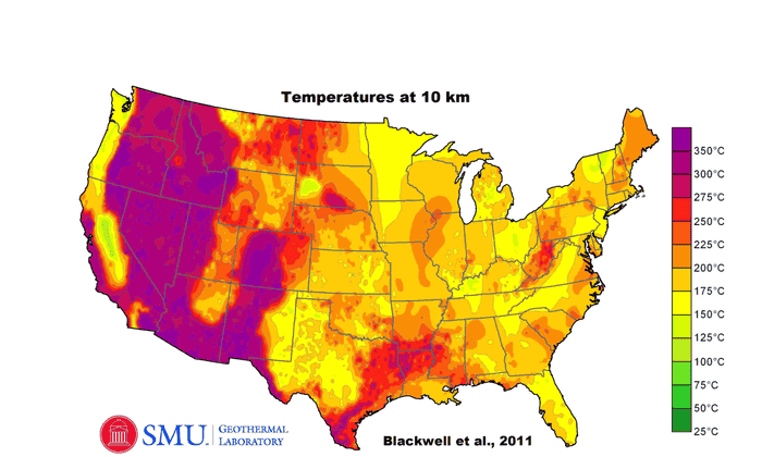

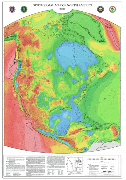

How are you deriving that qualification on geothermal being 'fabulously expensive'? Af far as I know, the cost of maintenance and virtual full automation of such a geothermal facility is significantly lower than nuclear. If you consider the long-term costs (maintenance, no need tor transport of materials to facility, labor) would make economic sense in the long run despite possibly high initial costs.
If digging deep is really that much of a problem, then why not utilize places like Yellowstone where the magma chamber there is 8 km underground.
Here's my logic in a nutshell:
Either way, we're going to have to dig deeper into the Earth's crust to find new sources of materials that any economy needs for growth. There is an absolute comparative advantage over such bombastic ideas of mining the moon or asteroids no matter how low launch costs go down. If, that is true then why not get started earlier than later? Obviously, this will never happen with our entire economy still stuck with oil and natural gas and the special interest groups or if we can extract what we need from the ocean, efficiently.
Oh, well.

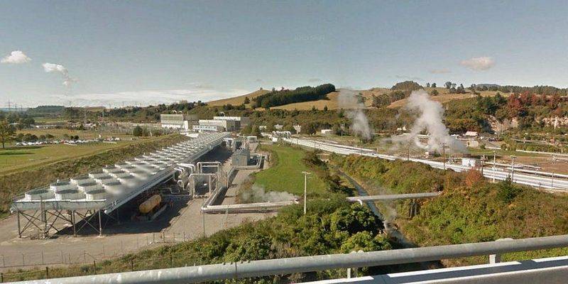

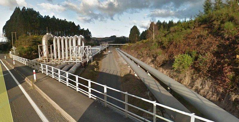

you are ... they are not negligible
I see millions upon millions in a geothermal installation like this
cost of the bores, many 10's of km of pipping large buildings, turbines and generators and the maintenance thereof
and this is where the energy source is less than 1000m deep
and that is only a small portion of the overall installation that can be seen
Dave

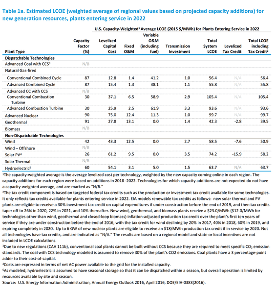

First I would like to explain the idea of LCOE;
The levelized cost of electricity (LCOE), also known as Levelized Energy Cost (LEC), is the net present value of the unit-cost of electricity over the lifetime of a generating asset. It is often taken as a proxy for the average price that the generating asset must receive in a market to break even over its lifetime. It is a first-order economic assessment of the cost competitiveness of an electricity-generating system that incorporates all costs over its lifetime: initial investment, operations and maintenance, cost of fuel, cost of capital.
The levelized cost is that value for which an equal-valued fixed revenue delivered over the life of the asset's generating profile would cause the project to break even. This can be roughly calculated as the net present value of all costs over the lifetime of the asset divided by the total electrical energy output of the asset.[4]
In very basic terms LCOE is the sum of the initial cost + yearly operating cost" over the life of the plant. Please also keep in mind that geothermal power plants can operate practically indefinitely until the temperature underground is exhausted, which is quite hard to do to my limited knowledge.
Now, with that understanding of the importance of levelized cost one can look at the graph of the cost of energy production per MWh:
https://en.wikipedia.org/wiki/Cost_...ted_LCOE_in_the_U.S._by_2020_(as_of_2015).png
As you can see, the assumption that cost is the limiting factor in construction of geothermal energy production is factually wrong, as per the information provided above. But, that is not a good source of information and quite insufficient in presenting the case for geothermal energy, hence I will refer the interested reader to a much better study on the comparative competitiveness of geothermal to all other sources of power production.
Levelized Cost and Levelized Avoided Cost of New Generation Resources in the Annual Energy Outlook 2016
Here is the take home message on page 6, table 1, in that report:
Now, some people may say that these are only projections of costs for a few idealized regions. However, there is research showing that these regions are not few and sparse.
This is true if there are cracks that allow some fluid to transport heat. If there are no cracks, then heat storage will be exhausted. 100 m of solid rock is very good insulator. Cooling rock could cause more cracks, so this might not be a problem.
