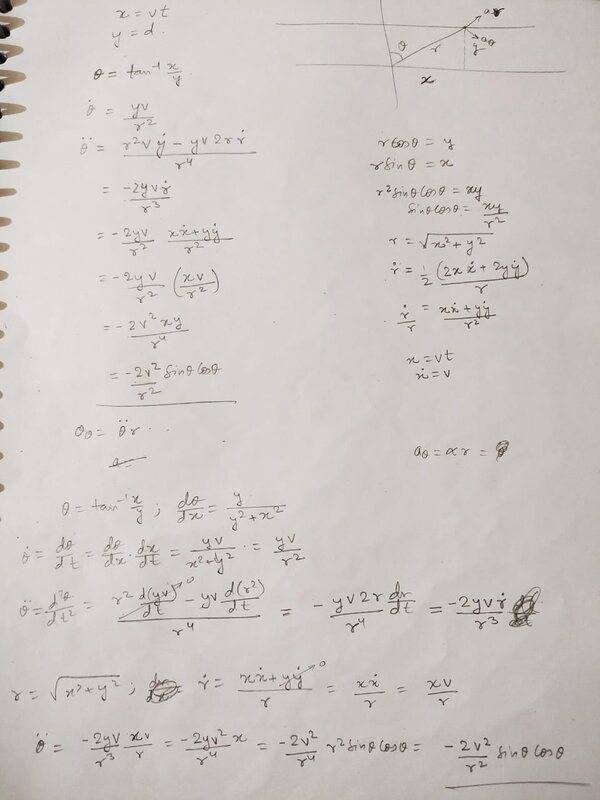

@PeroK :
I tried calculating ##\ddot \theta##, this is what I'm getting:
$$\ddot \theta=\frac{-2v^{2}}{r^{2}}Sin\theta Cos\theta$$
In the denominator, you've written ##d^2##, where'as in my calculation I'm getting denominator as ##r^2##.
Here's my calculation :
I couldn't understand, why you've written ##\tau= ma_{\theta }##.
Also, in the subsequent step, you've written ##ma_{\theta }=mr^{2}(\ddot{\theta }+\frac{2\dot{r}\dot{\theta }}{r})##. I suppose, there's some error in this step. Please clarify these 2 points.
Yes, you're right. I had two mistakes in mine. It was too early in the morning!

@PeroK, I had pointed out 2 errors(one of which was that the denominator is ##d^2## in your calculation) and had asked a question in post #21.
In your post#22, I'm not sure, which mistake are you referring to. Also, please let me know why you had written ##\tau=ma_{\theta}## in post#20.
NTesla said:
@PeroK, Also, please let me know why you had written ##\tau=ma_{\theta}## in post#20.
That was just a typo, I missed out an ##r##. I've fixed both errors now. I should have had ##\cos^3 \theta##. I'll type it up.
FYI what I did was: $$\tan \theta = \frac{vt}{d}, \ \ (\sec^2 \theta)\dot \theta = \frac v d, \ \ 2(\tan \theta \sec^2 \theta) (\dot \theta)^2 + (\sec^2 \theta) \ddot \theta = 0$$ Hence $$\ddot \theta = - 2(\tan \theta )(\dot \theta)^2 = -2\tan \theta (\frac{v^2}{d^2}) \cos^4 \theta = -\frac{2v^2}{d^2} \sin \theta \cos^3 \theta$$
Which is the same as yours with ##d = r\cos \theta##.

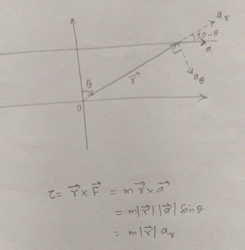

@PeroK : Here's how I calculated ##\tau##. However, something is wrong, which I don't understand what it is. Please help.
My calculation of ##\tau## is: ##\tau =\overrightarrow{r} \times \overrightarrow{F} = m \overrightarrow{r} \times \overrightarrow{a} = m|\overrightarrow{r}||\overrightarrow{a}|Sin\theta =mra_{r}##.
However, you've written ##\tau = mra_{\theta}## in post#20.
As an aside, when I have to deal with situations of this kind, I use the general form for the acceleration in polar coordinates $$\frac{d^2 \vec r}{\text{dt}^2}= \left(\ddot{r}-\dot{\theta }^2 r\right)\hat{r}+ \left(r \ddot{\theta }+2 \dot{\theta } \dot{r}\right)\hat{\theta }$$ and then apply it to the trajectory, in this case ##\vec r=vt ~\hat x+y~\hat y##. To derive the above equation, write ##\vec r=r~\hat r,## note that ##\dfrac{d\hat r}{dt}=\dot \theta~\hat \theta~ ;~~ \dfrac{d\hat\theta}{dt}=−\dot\theta~\hat r## and differentiate twice.
I don't understand what you've done there. In any case: $$|\vec r \times \vec a| = |\vec r \times (a_r \hat r + a_{\theta} \hat \theta)| = |ra_{\theta}|$$
I just figured out where I was going wrong with my calculation of ##\tau##.
