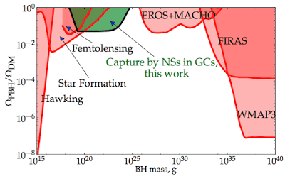

In terms of MACHOs are a dark matter candidate, only the very top part matters, since 10-2 means just 1% of dark matter can be accounted for by MACHOs of that type. You really need to be above 10-1 (i.e. 10%) to be considered as a significant source of dark matter phenomena.
As this chart shows, there are pretty significant observational constraints on the size of primordial black hole dark matter, however (relying mostly on this source). The sweet spot is 10^22 kilograms, which is a bit less than the mass of the Moon (which is 7*10^22 kilograms), plus or minus, which would imply a typical primordial black hole with an event horizon radius of about 0.1 millimeters.
Another paper on PBHs was even less bullish:
We investigate constraints on primordial black holes (PBHs) as dark matter candidates that arise from their capture by neutron stars (NSs). If a PBH is captured by a NS, the star is accreted onto the PBH and gets destroyed in a very short time. Thus, mere observations of NSs put limits on the abundance of PBHs. High DM densities and low velocities are required to constrain the fraction of PBHs in DM. Such conditions may be realized in the cores of globular clusters if the latter are of a primordial origin. Assuming that cores of globular clusters possesses the DM densities exceeding several hundred GeV/cm3 would imply that PBHs are excluded as comprising all of the dark matter in the mass range 3×1018g≲mBH≲1024g. At the DM density of 2×103 GeV/cm3 that has been found in simulations in the corresponding models, less than 5% of the DM may consist of PBH for these PBH masses.
Fabio Capela, et. al, "Constraints on primordial black holes as dark matter candidates from capture by neutron stars." Phys. Rev. D 87, 123524 (2013) (link is to open access pre-print version conformed to final print version).
Since the chart above was made the observational constraints on PBHs have further tightened. For example:
We model the accretion of gas on to a population of massive primordial black holes in the Milky Way, and compare the predicted radio and X-ray emission with observational data. We show that under conservative assumptions on the accretion process, the possibility that O(10)M⊙ primordial black holes can account for all of the dark matter in the Milky Way is excluded at 4σ by a comparison with the VLA radio catalog at 1.4 GHz, and at more than 5σ by a comparison with the NuSTAR X-ray catalog (10 - 40 keV). We also propose a new strategy to identify such a population of primordial black holes with more sensitive future radio and X-ray surveys.
Daniele Gaggero, et al., "Searching for Primordial Black Holes in the radio and X-ray sky" (Pre-Print December 1, 2016).
Another recent paper constraining MACHOs as cluster dark matter (keeping in mind that galaxy clusters are inferred to have much more dark matter proportionately than any kind of galaxy) finds:
Galaxy clusters, employed by Zwicky to demonstrate the existence of dark matter, pose new stringent tests. If merging clusters demonstrate that dark matter is self-interacting with cross section σ/m∼2 cm2/gr, MACHOs, primordial black holes and light axions that build MACHOs are ruled out as cluster dark matter. Recent strong lensing and X-ray gas data of the quite relaxed and quite spherical cluster A1835 allow to test the cases of dark matter with Maxwell-Boltzmann, Bose-Einstein and Fermi-Dirac distribution, next to Navarro-Frenck-White profiles. Fits to all these profiles are formally rejected at over 5σ, except in the fermionic situation.
Theodorus Maria Nieuwenhuizen "Subjecting dark matter candidates to the cluster test" (October 3, 2017) (omitting from the abstract conclusions about sterile neutrino dark matter candidates).
It also turns out that the model used in many PBH exclusion analyses is actually too lenient and that more realistic modeling makes the exclusions even tighter.

PBHs can only make up a significant fraction of DM if they are very small, i.e., less massive than the moon.​
From https://en.wikipedia.org/wiki/Hawking_radiation
However, since the universe contains the cosmic microwave background radiation, in order for the black hole to dissipate, it must have a temperature greater than that of the present-day blackbody radiation of the universe of 2.7 K = 2.3×10−4 eV. This implies that M must be less than 0.8% of the mass of the Earth[21] – approximately the mass of the Moon.​
If I am understanding all this correctly, if a sufficient number of moon size or smaller PBHs exist, they could not be detected by observing their Hawking radiation evaporation. I am not knowledgeable enough to read the diagram in #31 to estimate the number of possible PBHs that would be sufficiently larger than the moon to have their evaporation radiation detectable. Can you help me with that?
Regards,
Buzz
  • #35
Nobody directly observes Hawking radiation. One uses its predicted evaporation rate and the age of the universe to determine how big PBHs created in the Big Bang era would be today. This sets a lower bound on the size of PBHs that still exist today.
You put an upper bound on the size of PBHs mostly based upon the failure of microlensing observations to see light bending in ways consistent with masses of a certain size or larger. If PBHs were much larger than the Moon in mass, we would see microlensing caused by PBHs all over the place with telescopes.
We know the total inferred amount of DM, for example, in the Milky Way, from star dynamics and gravitational lensing. And for any given PBH mass, you can determine the number of PBHs per unit volume that have to exist to produce that quantity of DM. You can then determine how common PBH scale gravitational lensing should be per area viewed with telescopes, and if the observed amount of lensing is much lower than it should be given this analysis, then you know that the PBH hypothesis to explain DM is wrong.
In reality, of course, PBH DM would not all have exactly the same mass. And, if you make reasonable estimates of the distribution of PBH DM around a mean value as one of the links I reference does, it turns out that the exclusion of PBH DM is stronger than it would be if there was a uniform PBH mass, because the heavier than average PBHs would have a stronger signal which makes it easier to detect, than if every PBH were exactly the same mass, because it makes some lower resolution lensing measurements more useful.
The radius of a PBH for a given mass is determined using GR.
