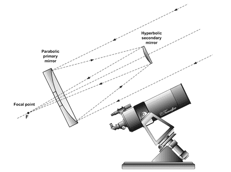

But I couldn't quite swallow the whole of that post because of the Cassegrain telescope.
sophiecentaur said:
The rays coming off a convex mirror always appear to come from a point behind the surface of the mirror so that image is always virtual and smaller. The image in a plane mirror is, likeways, virtual because it appears somewere it can't actually be. ...
So here, have we got a concave mirror forming a real image (which the light does not pass trough after reflection) which forms a virtual object for the convex mirror, with a virtual focal length, which forms a real image. And a Newtonian reflector would produce a real image from a plane mirror, again using a virtual object.
I think you can get any sort of image off any lens or mirror, if you do it right.
Otherwise, SC's got it nailed, even if I feel we should modify it to something like, rays converging towards a point in space that they would pass through if you didn't put something in the way!
But whatever you do, don't just rely on -ve answers being virtual, unless you already understand this and know you're using a real-is-positive sign convention.

That's how I feel about it, too. (I seem to remember a thread not too long ago that also got stuck on this point.)
Yes, absolutely. The "six articles" can only apply for a single optical element. Several elements can present the following element with a Virtual Object and then the rules go out of the window. (e.g. your Cassegrain system).
But this all shows the futility of losing sleep over what name to give something when the calculations deal with it perfectly well.
