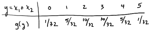

I'm referring to this table:
I don't understand the relationship between that table and the OP. That table appears to be more to do with tossing a coin 5 times than with rolling a die twice.

I'm just giving an example of discrete distribution table from the internet. Maybe he can recall if it was previously taught.
More usefully, if you have two random variables, X and Y, then E(X+Y) = E(X)+E(Y). You can use this both to get the expected value of the sum of two rolls of a die, and to get the expected difference from the other sum.
What did you do? Did you use the Discrete Binomial Distribution and why do you have 10/32 in the middle?
