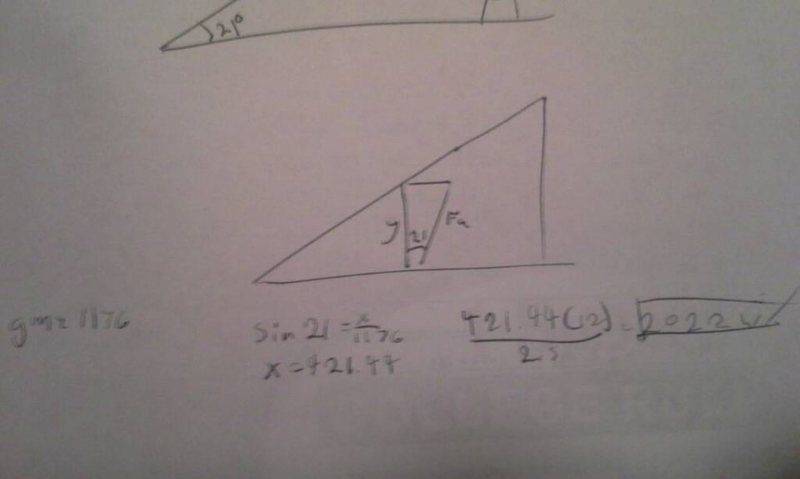

A cart travels up a hill at a constant velocity in 2.5 (s). What power is developed by the cart?
m=120 kg
meters=12m
θ=21°
P=w/t
w=F(parallel)×meters×cosθ
P= w/t= Fdcosθ/2.5= F(12)(.93)/2.5= 11,2F/2.5= 4.5F
How do I find F?

Hmm..I'm going to try squeezing in a bit more. Do you know how to draw a free-body diagram? If you do, draw one for the car.
Now, draw the components along the incline. The net force along the incline must be zero, as we have seen earlier. Consider mg to be the force of gravity and a random variable , say F, for force exerted by the car. You will see that that F is independent of the normal.
Can you find out the relation between mg and F, using all that has been mentioned so far?

So then there's no relevant relation between mg and Fn.
Because i was hoping cos21 may subtract from mg to acquire Fn.
Am I going about this incorrectly?
-In this question. I hope I've cleared that satisfactorily.
You've gotten the basic diagram correct. Take components of the forces along the incline.

I think I may have gotten it.
You need to use trig to make a triangle with g and Fa as sides.
While I can't find the exact force, I can find the minimum required to keep it stationary. Its what the book is looking for, but in the real world, how could I find the exact force with what little I have?
1. Net force zero does not imply that a body is stationary. It means net acceleration is zero; and hence, it can move with constant velocity/ be stationary.
2. The question asks you for the Fa which gives net force zero. Anymore force, and the car would have a net acceleration upwards. So the word 'minimum' force is not correct. It is a particular value of force that gives zero acceleration, or constant velocity.
Thta is what you have to find.

I'll try again. All the question requires is for you to take components of forces along the incline. Do you know how to do this?
Qwertywerty said:
This is a little vague.
I believe this is something along the lines correct?
Could you explain to me, what you did after finding x?
P.S. Seems correct. Want to know whether you used correct reasoning.
I solved for power.
And which force's exerted power did you find?
Fa up the incline
