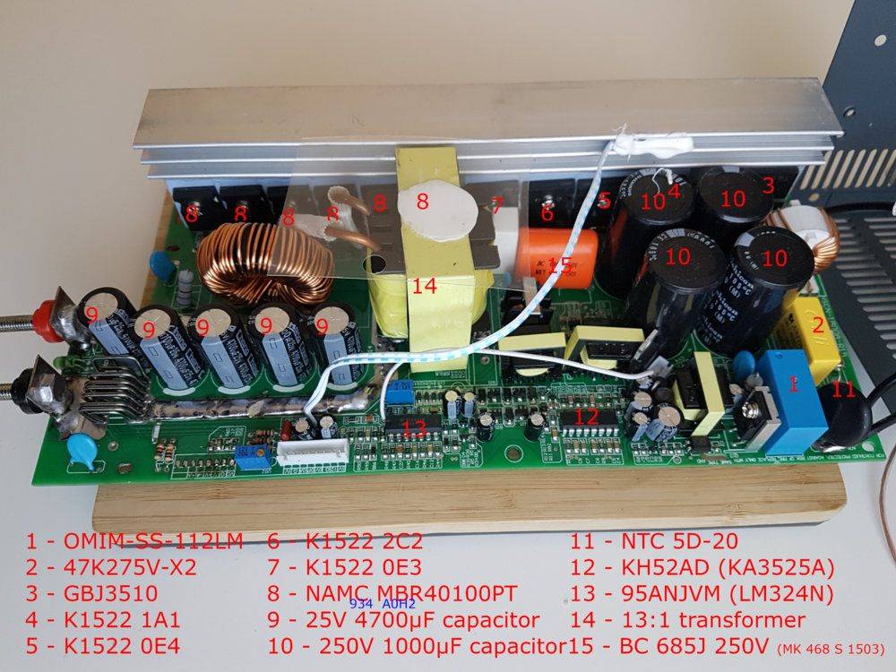

Below is also a product image. If this power supply at such size (29x13x7cm) were well designed what do you think how much current/power would it be realistic to draw from it without need for fan to start spinning (lets say the threshold is 50C for both transformer and heatsink and whatever gets there first starts the fan)?

can you give us the model of the smps or something? By the picture it seems like a weird psu there seem to be many transistors etc.

I don't think model details would be of much help here.
https://www.aliexpress.com/item/4000328528983.html?spm=a2g0s.9042311.0.0.19f84c4dVuoDDx
If you want I can make photo gallery of inside photos it and link it here.
artis said:
like the one I built I had more space available and used larger transformer core etc so I don't have any forced ventilation at all even at full power.

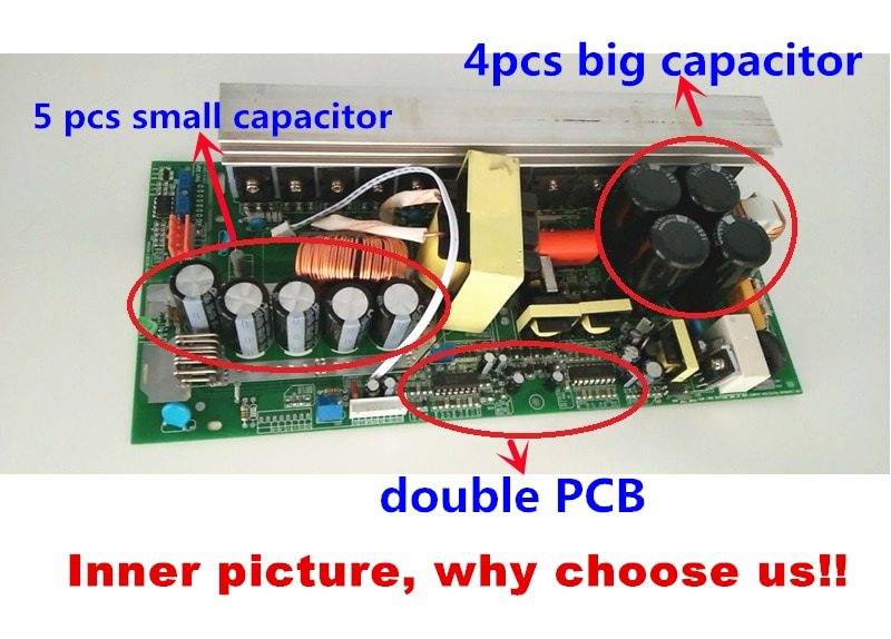

I have just read the new review of the product.
AliExpress titles and descriptions include irrelevant key words associated with similar products that increase the item hit-rate in a search. You need to be aware of that as it leads directly to confusion, and misrepresentation of the item being listed. It also makes it difficult to search for an item you need, because of the huge number of irrelevant search results.
In my experience, when it comes to disputes over faulty goods, or misrepresentation of a product by the Seller, AliExpress stands behind the Chinese seller, while eBay and Paypal protect the Western Buyer.
So, if I find what looks like a good device on AliExpress, I then search for the equivalent device on eBay, then buy it from the eBay supplier whenever possible, even if the initial price is higher.
If you cannot get a return on the supply misrepresented by the seller, you could replace the noisy fan with a larger and quieter external fan that runs at a lower speed, from an old computer supply, or from eBay.

Also I created this picture with part names for more info.
The 230 VAC input is rectified into the big capacitors (10), at 325 VDC.
The controller (12) drives transistors (4,5,6,7), to alternately switch that DC into 325 VAC at 50 kHz in the transformer (14) primary.
The transformer (14) low voltage secondary, at 50 kHz, is rectified by diodes (8,8,8,8), to make the low voltage DC output on capacitors (9,9,9,9,9).
The op-amp chip (13) senses the actual output DC voltage, it sends signals to the regulator (12), which adjusts the on time of the alternating input transistors (4,5,6,7) to control energy flow and so stabilise the output voltage.
