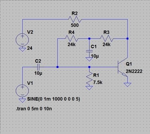

mt1200,
After I saw your post I put together a circuit in LTSpice using a 2N2222 and got a voltage gain of about 330. Furthermore it would be easy to modify the circuit to get higher gains than that. I'm not claiming it is a good circuit, only that it illustrates a way to bias a transistor for high gain. Don't forget that the higher the gain, the more easily the circuit will oscillate. The advice to design a 2 stage circuit with each stage having a gain of 12.25 is good advice. My example is for demonstrating a biasing for high gain.
So even though such a high gain stage is risky because it will oscillate if you're not careful, it does have some advantages over the configuration most frequently taught in the schools. First it is biased from the collector voltage. This means the collector voltage will stay the same regardless of your supply voltage. So if your supply has ripple or noise on it, the ripple or noise at the output of your amp will be much better than with the other configuration. Also for RF applications this is the preferred configuration as using an emitter resistor will often cause an RF amp to oscillate.

skeptic2 said:
mt1200,
What you got there is the standard textbook biasing scheme for a common-emitter amplifier. However, it doesn't solve the situation the OP had in that the measured gain was different from the calculated gain. The gain in your circuit is proportional to dc current gain beta (or hfe) and according to the BJT datasheet:
http://www.fairchildsemi.com/ds/PN/PN2222A.pdf
hfe can vary from 100 to 300! No wonder this circuit's gain is all over the place! Use negative feedback and repent!
Did you have a load at the output? The calculations for gain with a load involved are different.

Another other source of error is if you use the DC current gain of a transistor (Hfe, as measured in a transistor tester) for your calculations. This is almost unrelated to hfe which is the real current gain for small signals.
"Biasing" really only refers to the process where you adjust the base current of the transistor so that it is operated in linear mode. Voltage gain is mostly concerned with the collector and emitter resistors and the current gain of the transistor.
Ah, that's probably what got me. I realize now that I had used the figure I got off of the DMM's tester to make my calculations. Thank you.
