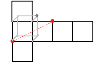

Question: An ant starts at one vertex of a solid cube with side of unity length. Calculate
the distance of the shortest route the ant can take to the furthest vertex
from the starting point.
Now, in the answer, the cuboid is unfolded and a rectangle of side 1 and 2 is formed. Calculating the hyptoneuse gives the distance.
That was the proposed solution. I wanted to calculate it via sqrt(1+1+1). Why is my answer wrong?

Yes, the shortest distance between the furthest vertices is along the body diagonal (the red line in the picture) but can the ant move along it?
Then it should be 1+sqrt2

And the answer is sqrt5

Follow the hint in the solution, unfold the cube. The shortest way between the red points is the straight line segment connecting them.
But how can an ant travel along the diagonal you've made?

The ant can climb on a sheet of paper, either it is folded or unfolded.
Cut the pattern in Post #5 and fold it to make a cube.

Unfolded, it is the same sheet of paper, as the cube was made of. On the plane sheet, the shortest path between two points is the straight line connecting them. So unfold the cube, connect the two points with a straight line, fold back making the cube, and you see the shortest path on the surface of the cube.
This method is very easy and can be used for other shapes which can be unfolded into a plane pattern.
But you can do it mathematically. The path should cross an edge, see figure. Write up the length of the path as the sum s1+s2, in terms of x. Find the minimum.
