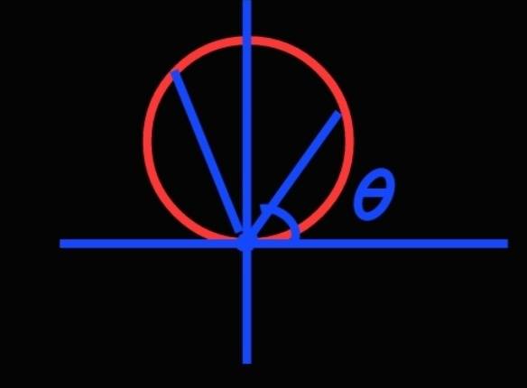

So I have a ring(red) of uniform charge ##\lambda## per unit length, and I want to calculate the electric potential at the origin (actually on any point of the ring). It is clear that the ring is given by the equation $$r=2 R \sin \theta$$, in polar coordinates, where R is the radius of the ring. Since potential is given by $$V = \frac{1}{4 \pi \epsilon_0} \int \frac{dq}{r}$$, and $$dq = d\ell \lambda$$, but $$d\ell = \sqrt{(\frac{dr}{d\theta})^2 + r^2} d\theta = 2R d\theta$$. Therefore, $$V = \frac{1}{4 \pi \epsilon_0} \int \frac{d\ell \lambda}{r} = \frac{1}{4 \pi \epsilon_0} \int^{\pi}_{0} \frac{2R\lambda}{2R \sin \theta} d\theta = \frac{1}{4 \pi \epsilon_0} \lambda \int^{\pi}_{0} \frac{1}{\sin \theta} d\theta$$, which does not converge... what's wrong?

Yes because the ring is infinitesimally thin and has finite charge density ##\lambda## the electric field (and potential) is infinite for points on the ring circumference. Electric field and Potential are well defined for points on the interior or the exterior of the ring though.

My explanation is that we know from Gauss's law in differential form that $$\nabla\cdot\vec{E}=\frac{\rho}{\epsilon_0}$$ and $$\nabla^2 V=-\frac{\rho}{\epsilon_0}$$.
Where ##\rho## is the volume (not the linear) charge density. Because the ring is infinitesimally thin the ##\rho## of the ring become infinite for points on the ring, hence from the above two equations, electric field and potential become infinite too.

This argument is unfortunately invalid as it does not work for a surface charge where the volume charge density becomes formally infinite at the surface, but the potential is well defined.
Instead, we need to argue how the potential behaves as we get closer to the wire. As we approach a line charge and the distance ##\ell## to the charge is much smaller than the curvature radius of the line, the porential behaves as proportional to ##\ln(\ell)## (it must because of the divergence theorem). Therefore, the potential diverges and the field diverges as ##1/\ell##.

Yes ok I see now, infinity of the divergence of a field at a point doesn't necessarily imply infinity of the field at that point.
Indeed, but almost always. The exception is when the source is spread over a hypersurface of one dimension lower than the space itself. The reason is that the one-dimensional Green function of the Laplace operator does not diverge, but for any higher dimension it does
