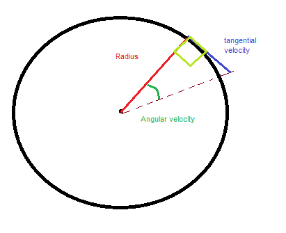

Anyway, for (b), for the tangential speed, you can use trig to figure that out. See the diagram, I think you can figure it out.

Oh wow... Forgot to post the diagram XD

Thanks! I see gravity has no effect. I thought of it as a ball rotating on string.
