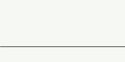

Since the wheel is rolling , vcm=ωr , acm = αr
The wheel is in pure rotation about the point O where it touches the surface .
The point P is a distance 4/3 from the bottom point .
Angular acceleration of the point = 3 rad/s2
vP = 4m/s
Radial acceleration of the point P about bottom point O = vP2/(4/3) = 12 m/s2 .
Are the two components of acceleration correct ?

The linear acceleration consists of the radial acceleration (which you found) and the tangential acceleration (which follows swiftly from the angular acceleration).
Tangential acceleration = 4m/s2
Radial acceleration = 12 m/s2
Net acceleration = √(122+42) = 4√10 m/s2
Is that correct ?

Yes, except that what you called net acceleration is the magnitude only. Acceleration is a vector, so I would think you should give the components separately in the answer. Either that or magnitude and direction.
Ok.
I suppose the question is asking for the magnitude of linear acceleration of the point .
But unfortunately , this answer is wrong .
Do you see any mistake ?

I think there might be a problem with the way you are obtaining the radial acceleration. By the logic you used, the center of the wheel is 1 m above point O, so the center of the wheel has a radial acceleration of 9 m/s^2 (i.e., [3^2]/1). That's not right. The center of the wheel should have a radial acceleration of 0.
Now consider a point at the edge of the wheel. It will travel in a cycloid pattern:
As you can see, the radius of curvature when the point is on top is significantly greater than 2R. I think the flaw in your logic is the assumption that the entire wheel is rotating around point O. It doesn't really work that way. Even though things are also accelerating linearly (in addition to rotational acceleration), things are still "rotating" (strictly speaking) about the center of the wheel.
The point you are concerned about isn't at the center or the edge, but rather somewhere in between. So as a sanity check, I would expect the radial acceleration to be somewhere in between what you would get for those other two points (center or edge).
[Edit: Source of animated gif: https://en.wikipedia.org/wiki/Cycloid#/media/File:Cycloid_f.gif]
As another point of reference to ponder, a point at the very bottom of the rotating wheel (at point O) has a instantaneous velocity of 0 m/s. But is its instantaneous, radial acceleration also zero?
[Hint: The answer is "no."]

Yes, the pattern in the animated gif shows a frame corresponding to the flat, horizontal surface. I'm guessing that the values in the problem statement (the 3 m/s velocity of the center and the 3 m/s^2 horizontal acceleration of the wheel's center) are all relative to the flat, horizontal surface.
But for the moment, it might help to use a non-rotating, accelerating frame that corresponds to the center of the wheel, by subtracting out the 3 m/s^2 in the horizontal direction. This way, the center of the wheel isn't accelerating in the new frame. (You can always add it back into the x-component later, before your final answer). Now everything is rotating around the center. What's the instantaneous, radial acceleration of the specified point now? What direction is it in?
So when we change back to the frame of reference of the flat surface, is the acceleration that we add back in perpendicular to the point's instantaneous, radial acceleration?

The bottom of the wheel is accelerating relative to the centre of the wheel. So, its acceleration is not the same as the centre.
Acceleration must be the same in all inertial frames. What happens if you consider a frame moving at ##3m/s##?

That is acceleration relative to point O, whose acceleration you would then need to calculate.

Yes, but point O is accelerating. The bottom of the wheel is instananeously at rest, but it is accelerating!

You can calculate the instantaneous acceleration of this axis of rotation. It is not zero.
If you consider a simpler problem where the wheel is not (linearly) accelerating, then every point on the rim of the wheel is accelerating. In fact, every point except the centre is accelerating towards the centre.
You cannot ignore this acceleration.
PS In fact, a good test of your method would be to calculate the acceleration of the centre of the wheel.

It's not. You correctly calculated the acceleration of point P relative to point O. Your problem is that point O is accelerating.

You could, hypothetically, choose an accelerating frame where point O is the center (where O is on the bottom of the wheel) but it's not very useful in solving this problem.
When using the frame of the flat surface, then no, the wheel is not rotating around point O, not even instantaneously.
Instantaneously, every point on the wheel is rotating around the center of the wheel. (The center of the wheel is accelerating linearly too, meaning that that bit of acceleration carries over to all points on the wheel.)
Let me put it another way. For every point on the wheel, you can break up its acceleration vector in the following ways:
The linear acceleration corresponding to the acceleration of the wheel's center, plus
its rotational acceleration about the wheel's center.
You can further break up the point's linear acceleration (which matches the acceleration of the wheel's center, for all points on the wheel) into its
x-component and
y-component.
You can further break up the point's rotational acceleration (depends on the point's distance from the wheel's center and the wheel's angular acceleration) into
tangential component and
radial component.
Once you know all 4, then you can add things (vector sum) back together at the end, once you know how the angles line up (how tangential&radial correspond to x&y).

I'm not going to discuss this any more until you have calculated, using your method, the acceleration of the centre of the wheel.
In fact, I'll do it for you:
Radial acceleration of centre of wheel relative to point O is ##9m/s^2## (vertically downward).
Is the centre of the wheel accelerating downward? Or, is the bottom of the wheel accelerating vertically upward at ##9m/s^2##? In the inertial reference frame of the surface?

The bottom is accelerating vertically upward w.r.t the center . Since center is accelerating horizontally , in the frame of the surface , net acceleration is the resultant of the two .

Exactly. The best approach is to analyse the problem relative to the centre of the wheel, as its acceleration is known.
Also, note that the instantaneous point of contact with the surface is accelerating upward absolutely (not just relative to the centre). The centre has no vertical acceleration.
