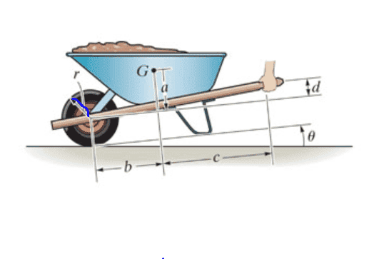

In summary, the problem involves a wheelbarrow with a mass of 63 kg and dimensions of a = 0.27 m, b = 0.43 m, c = 0.78 m, and d = 0.10 m. The goal is to determine the normal reaction on the tire and the vertical force on each hand, with the angle of θ = 30∘. To solve this problem, one must sum moments and forces in the x and y direction.
lc99
161
The wheelbarrow and its contents have a mass of m = 63 kg with a center of mass at G. Determine the normal reaction on the tire and the vertical force on each hand to hold it at θ = 30∘. Take a = 0.27 m , b = 0.43 m , c = 0.78 m and d = 0.10 m . (Figure 1)
Fx = 0
Fy =0
I cannot figure out the vertical force and horizontal force of the hand. Overall , I am just struggling on finding the correct angles for this problem. I've attached my sketch below..
Try summing moments about a point equal to zero, as well
