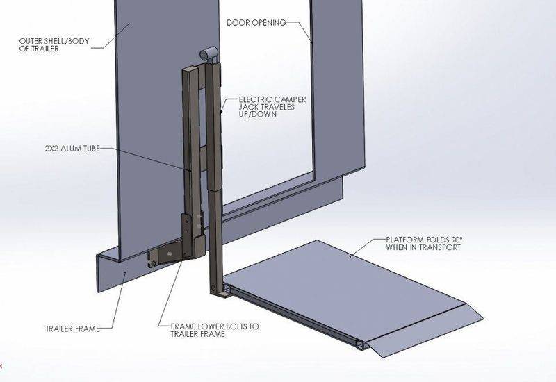

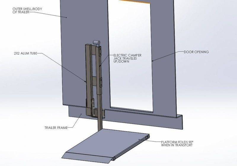

Hello all, sorry for the delayed response.. I have came up with a pretty good idea. And will post up a few pictures of the 3D model tomorrow. Basically, I designed a mount that will bolt to the trailer frame. That mount will support a vertical post (2x2 x.187w 6061sq tube). And bolted to that is a electric camper jack. Look up happijac 4800 jack on YouTube. It is basically a liner actuator capable of lifting up to 3000lbs +. I designed an aluminum frame that bolts and pivots on the base of the camper jack, that will stop at 90 degrees (parallel with the ground, and then will fold up 90 degrees so it's parallel with the trailer while in transport).
My issue is the camper jack is pretty slow... About .50" per 2 seconds. I would like to increase that to more like 2" a second if possible by re gearing the gearbox between the motor and the shaft. I do know some info on gear ratios, but the whole hp, ratio and what not has me a bit confused. Do you think the motor will be able to lift me faster with a lower gear ratio? (Remember the "stock" ratio/ motor was designed to lift 3000lbs. I only need it to lift a maximum of 300lbs)
Any thoughts on the re gearing of the motor?

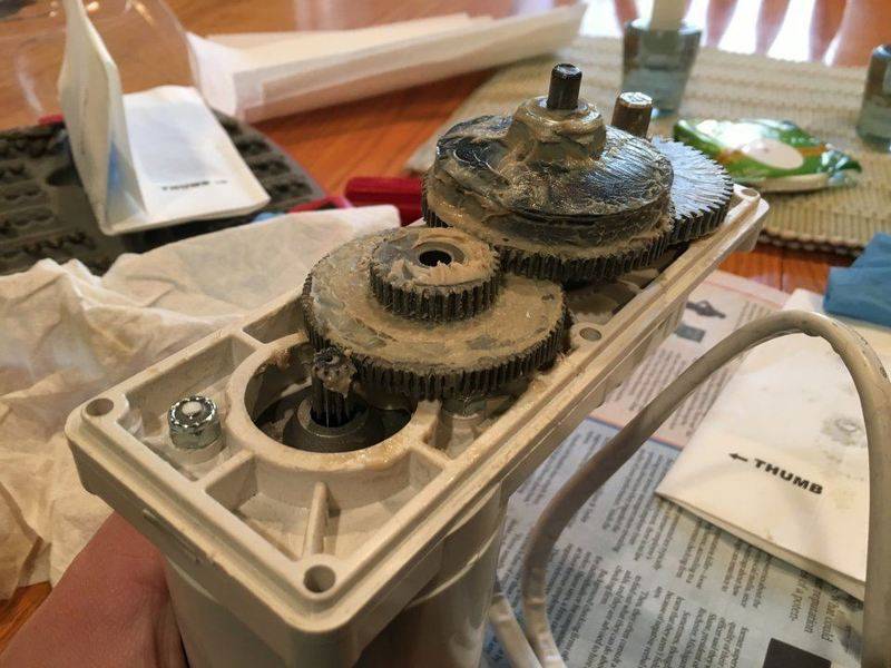

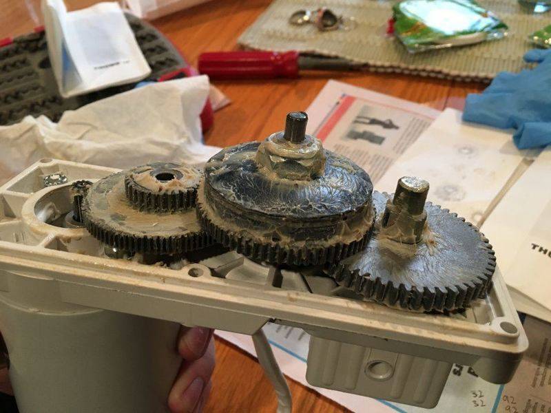

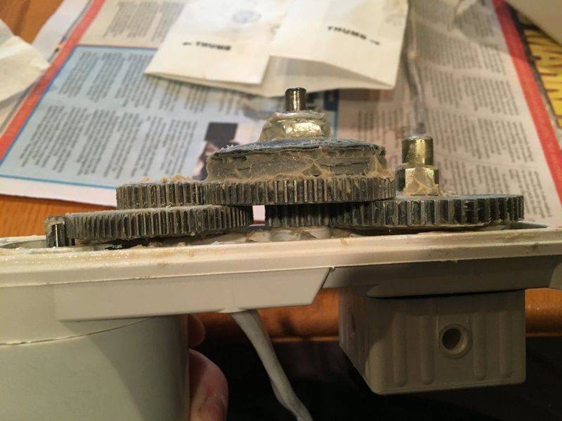

I will take the cover and take some photos of the inside of the gear housing later today. I will also count the teeth of each gear so we can determine the gear ratio, and go from there
Here is the lift concept I have come up with
View from a different angle. I will post pics of gearbox in a bit.
ok, so here are the pictures of the gearbox. and i counted the teeth on all gears and drew a representation on a sticky note. i hope you all can make it out clearly. and help me figure out the ratio?
Is there a way to make it a 2-sided lift? The one-sided lift looks real unbalanced...
as far as simplicity goes, no. the issue is with the door opening on the other side. if i went with the van style above, i would have to create a whole new trailer door to accommodate the width.
i may add an additional support that can slide up and down in a guide system to keep the camper leg straight (vertically) if the one sided load (weight on platform) hints at bending the tube to the left direction, which seems like a possibility considering the load (300lbs) will be all on the right.
It may require a second gearbox to be a 'donor' for gears, as well as some lathe work, but if you could take the 72 tooth and swap it around with the 32 tooth, that would get you pretty close to your goals
32:72 = 2.25:1
If swapped around the difference is
2.25*2.25 or 5:1... or 5 times faster than it currently is.. It should lift about 1 inch per second under load.. not blazingly fast, but much better than 1/4 IPS (which might be under no load, depending on the specs).
If you could find a motor a higher speed rating, that may be another way to go about it, it could afford to have as much as 10 times less torque (Maybe 6-8x to be safe) and still get the job done
