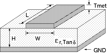

In class we only ever really use co-axle cables, micro-strip lines, parallel plates, and point charges as examples, as these all can be described by one of these 3 shapes. My question is asking about the more obscure shapes that could still technically be called one of these 3 shapes.
For example when talking about micro-strip or parallel plates the planes are always above and below each other, as shown in the picture bellow.
But can the two planes be next to each other? They would still be parallel, they are just now at the same height. For example a micro-strip with the feed and ground line both on the same side of the PCB.
It can be used everywhere where the requirements are satisfied, otherwise it would not be a theorem. This does not mean that it has to be useful everywhere, however.
A capacitor with parallel plates is probably easier to evaluate without Gauß, but this would give the same result.

I studying em as well. The way I understand it is that the reason these symmetrical surfaces are used is because the electric field is constant in magnitude and direction everywhere on the surface. This makes the integral trivial.
Gauss' law does apply everywhere, but it is only useful in this way in when there is high symmetry.
