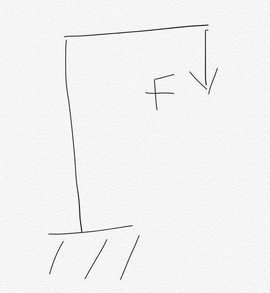

Hi, like the title says, how do we actually calculate when a cantilever beam fails in reality? We’ve been taught that these are absolutely fixed to the ground. However, in reality these would probably be bolted onto the ground, so how do we calculate the force trying to lift the fixed beam on the floor, created by the force at the end of the cantilever if the beam is fixed by something that would fail? I’ve attached a terribly drawn diagram above.
Thank you.

The lifting force comes from the moment divided by the distance between the center of the beam and the fastening point, I think.

edit: I see in your initial diagram you mean there is a cantilevered force at the top of the beam. You can get the lifting force by calculating the moment at the base of the beam and then dividing by the distance to the fastening point, as I said above.

I've currently solved it like this; however I feel like what I did assumes that the overall forces equals zero or I've overly simplified the problem.
https://ibb.co/hSbbfd
I've input my numbers into it but it comes out as a negative lifting force which means I've probably done it wrong.
Thank you.
In simple form, ignoring the vertical member, this just a standard lever problem . All you need in order determine the value of Fb to offset F is: Fb = Fx / Z and Fb is the force on your bolt.
@JBA I was about to post the same, then I started thinking about the plate extending to the left that will also be supporting the moment. I am trying to come up with a second equation to relate the support of the plate to the support of the fastening bolt.
If the length of the plate to the left is "n", then does 1/2nF = FbZ?
I'm thinking the plate support against the moment has a triangular shape, hence the 1/2n. Sorry if that is clear as mud - I can't make a drawing where I am right now.
Good catch. My mistake, You are correct. Assuming the base plate is rigid then the the base rotation point is the base edge opposite to the bolts, not the center of the pole. As a result, if we are not concerned with the base plate to pole connection, then the correct Z length in my equation would be the distance from that opposite edge to Fb. The result will be a lower Fb load than from my original equation.
Edit: On further thought, the distance of the vertical load on the arm from the back edge is also reduced from x to x- (the distance to the edge from the pole center) further reducing the Fb force.

On the side opposite the bolt, if there is a stiff plate on a rigid surface, there will be a gradually increasing reaction force that is proportional to distance from the beam center. This will help support the cantilevered F. The stiff plate is in the direction perpendicular to the force, as is the gradually increasing reactive force of the rigid surface on the stiff plate. Sorry still no picture possible.
If there is no plate on that (left) side, then all of the F / moment induced by F is supported only by the bolt on the side of the beam opposite the F.
Edit - I think @JBA 's description is easier to follow - the center of rotation becomes the end of the rigid plate, not the center of the beam.
