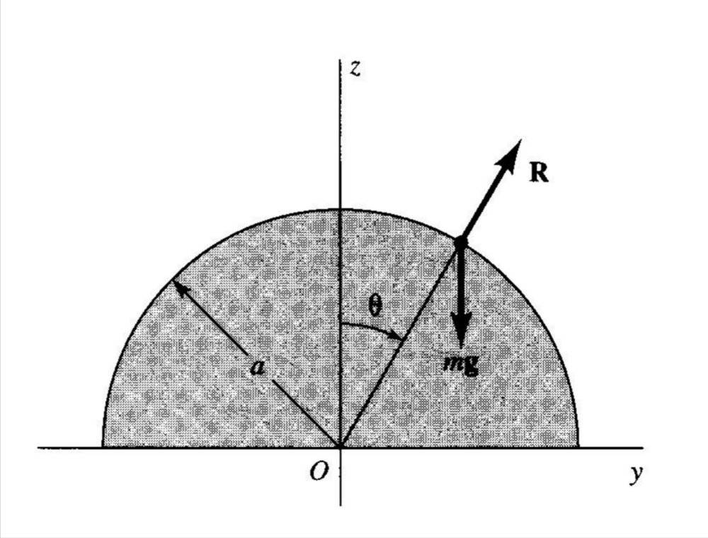

Calculating when does a particle falls off a dome
a = v^2 / r
A particle was resting on top of a dome and given a negligible push such that it falls. The question is at what angle will the particle fall off the dome.
The solution is that,
[tex]m\frac{v^2}{a} = mg\cos\theta - R[/tex]
and by conservation of energy
[tex]0 + mga = \frac{1}{2}mv^2 + mga\cos\theta[/tex]
then the angle is found to be
[tex]\theta=\cos^{-1}\frac{2}{3}[/tex]
What I don't understand is, when the particle exerts force on the dome due to gravity, why doesn't the dome follows Newton's third law and exert an equal but opposite force on the particle
[tex]mg\cos\theta = R[/tex]
but exerts a smaller force back to the particle such that a net acceleration towards the center is resulted in the particle instead?
You forget that the particle is moving and that a net acceleration is necessary to keep it on the circular path.

If a particle, under the influence of gravity, is on any surface, then it will try to fall through the surface. But, the surface will prevent it. Gravity and the normal force from the surface combine to move the particle along some trajectory on the surface. The particle may get faster or slower. In this case, it will get faster.
Once the particle is moving, it has a natural path under gravity: some parabola, based on the instantaneous velocity of the particle.
If at some point on its trajectory the natural path under gravity is above the surface, then it will leave the surface.
In this case, a particle is on the surface of a sphere/dome is compelled to move in a circular path (if it is simply given an initial impulse) until it reaches a speed where its natural trajectory is above the surface, at which point it leaves the surface.
This coincides with the point where the normal force reduces to zero; which also coincides with the point where gravity is no longer sufficient to continue the circular motion.

Clearly Newton's third law is not violated. There is a normal force on the particle, which is equal and opposite to the force that the particle exerts on the surface.
Your conceptual problem is that the particle is not exerting its full weight on the surface. Imagine, for example, that you construct a parabolic track. This track is exactly the shape that a projectile will take if fired at a certain speed at the top of the track. Now, in this case, the projectile will move along the track (theorectically it may be touching the track the whole way). But, it exerts no force on the track, because the projectile is actually in free-fall. In other words there is no normal force in this case.
Imagine, then, that the projectile is fired a little more slowly. Now the track is no longer the ideal parabola for the projectile. The projectile still moves along the track, but it's not quite in free fall this time. It's trying to move below the track. In this case there will be a non-zero normal force. But, this force will not be the full weight of the projectile.
If we analyse what is happening: some of the gravitational force is used to accelerate the particle in a curved path, leaving only some of the force to act as a force on the surface.
A related example is where an elevator accelerates downwards. You are still standing on the floor of the elevator, but only some of your weight is acting on the elevator floor. If you stand on a set of scales, they will record a lower weight while the elevator is accelerating. Once the elevator reaches a fixed speed, your weight will return to normal, as recorded on the scales.
The moral is that when an object is accelerating, you have to take that acceleration into account when looking at the force exerted by that object on an adjacent surface.

The particle does not exert force on the dome "due to gravity". The gravitational force mg is exerted on the particle by the Earth, and the particle exerts equal and opposite force on the Earth.
mg cos(theta) is the radial component of this force of gravity.
The other force acting on the particle is R, the outward normal force due to the surface of the dome. According to Newton's Third Law, particle exerts equal and opposite force on the dome.
The vector sum of these two forces - gravity and normal force- determines the acceleration of the particle while it moves on the surface of the dome. The radial component of the resultant force is equal to the centripetal force:
##m\frac{v^2}{a} = mg\cos\theta - R##, so
##R=mg\cos\theta-m\frac{v^2}{a}##.
The tangential component determines the acceleration along the circular track.
If the centripetal force needed requires zero or negative (inward) normal force, the particle does not stay on the surface any more, as the dome can only push it and is not able to pull.

You wrote in the first post
mgcosθ=R
You can not say that the particle exerts force on the dome due to gravity. It is the Earth that exerts force due to the gravitational interaction. The particle and the dome exert force on each other because they touch each other and interact. And this force is not equal to mgcosθ. The force depends on the motion of the particle, its speed. If the particle does not move,the force is mgcosθ, otherwise it is less
You can determine this force of interaction from the resulting motion of the particle. ##R=mg\cos\theta-m\frac{v^2}{a} ##
