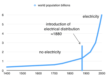

Electric power distribution became necessary only in the 1880s when electricity started being generated at power stations. [ref]​
Prior to 140 years ago, the reliable supply of electricity was zero, yet everyone seemed to survive.
[google google google]
242467
Ok. Maybe electricity does help us survive a bit better. But the curve was positive before then. It's just more positive now.
The business model of of the electric utility company (public or private) may not survive.
As far as I can tell, the current business model is already broken, so I hope it does die.
At a much lower population, with a much lower standard of living, with much slower communications...
