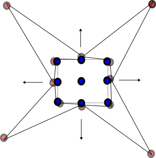

why to use more mesh elements in finite element method?
the simple rectangular isoparametric element (curved edges element) can be used to generate many complex shapes like..
square to circle
square to triangle
two square elements to annular.
and the results i calculated in python code (2D case) are very accurate, then i confused why to use complex mesh generator software etc.
for example, i calculated electric field distribution complex shape waveguide using single rectangular Lagrange element of order 4 ( it has 25 interior points). here i didn't used any mesh generator software

Isn't there a risk though that your simplification will fail? Perhaps folks try it both ways and when they see the simpler mesh works they go with it otherwise they stick with more elements.

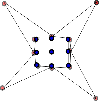

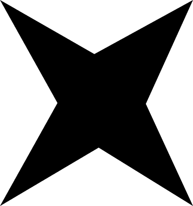

suppose i have star domain as show in figure, will it required mesh generation software like gmsh etc? i will say no, this star shape can be covered (100% without discretization error) using single isoparametric rectangular element of order 2 just by displacing boundary nodes inside.
Try a star where one of the angles is 0.1 degrees. And the star has a round hole in the middle. And it is 3D and being held by the statue of liberty. You will have a hard time generalizing this to a lot of different shapes.
But for simple shapes, you can indeed increase the order of the basis function to 100 or so and work with a single element. That is basically spectral element methods. Convergence of the error with degrees of freedom is much faster when you increase the polynomial degree, compared to increasing the number of elements. However, your solution needs to be differentiable up to the order of the polynomial. Many practical problems are not infinitely differentiable. Shock waves for example are discontinuous and not even differentiable once in the neighborhood of the shock. This is why aerodynamics codes try to locate the position of the shock wave, and they switch to lower order schemes or use some other special tricks in the neighborhood of the shock. Or you could use discontinuous Galerkin methods, where the solution is allowed to be discontinuous from one element to the next. There are many different tools available for many different problems.

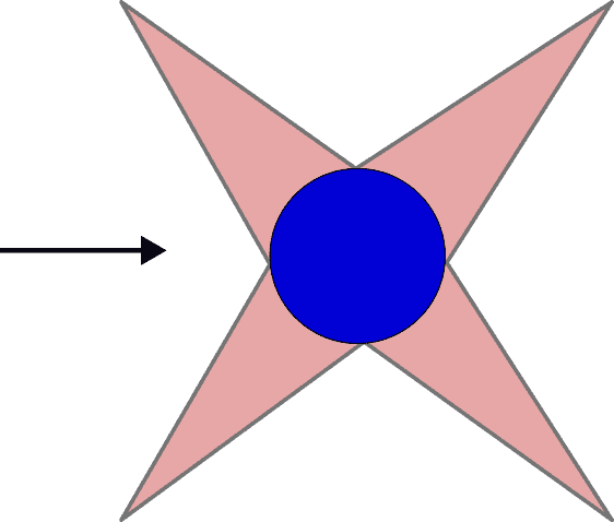

the middle is a second order rectangular element (blue dots, 9 nodes) , just displacing nodes in the direction of arrow we can generated circle of any radius. for making star, four elements of order 1 are used (4 nodes for each element). we can make any angle no matter because it is made by using Jacobin transformation with the help of Lagrange interpolation basis functions. here is no need to use any mesh generation software, just coordinates of vertices are needed to generate complex shapes. as you commented out "your solution needs to be differentiable up to the order of the polynomial" but there is no relation between domain discretization and actual solution obtained. i mean degree of polynomial used for obtaining solution may be different than the domain discretization.
I'm still waiting for the statue of liberty...
So it is not possible anymore to do this with a single element... I do not think you understood what I was trying to say: Your method is perfectly fine for simple geometries, but you need to use more elements to capture more complicated shapes, exactly like what you did. And these elements need to have certain geometric properties or the solution will have very high numerical errors.
No, you cannot. The solution on the domain is affected by the angle that you choose. If the angle becomes smaller, your error will increase. The usual discretization errors that are mentioned in the textbooks are only for perfect squares and triangles.
But there is a relationship between domain discretization and the solution. Your discretization determines the solution. And the solution is determined by the number of degrees of freedom that you introduce, which is a function of the number of finite elements and the polynomial order of the elements. So: yes, the degree of the basis functions can be different per finite element. But you cannot in general choose the order of the basis functions independently from the finite element discretization.
For instance the sides of the circle need to be discretized using finite elements with at least a second order basis function to capture the geometry exactly, or you introduce an additional discretization error.

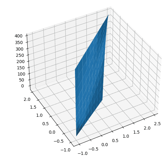

thanks for sharing "Sherwin and Karniadakis, hp/spectral element book". i was completely unaware of this element. the co-incident is that, i made complete solver without any mesh software in python which is resemble this concept. of course, "statue of liberty" is also possible! but i have to take help of Blender (modeling software, it is also made in python) for generation of node coordinates. one question i would like to ask, as you mentioned in post "If the angle becomes smaller, your error will increase". but, i just displacing nodes to make small angle in element and which is completely in accordance (obeying geometry rules) with the geometry, then why should be there error? i am not discretizing any thing. for example, i have solved Laplace equation with Dirichlet and Neumann boundary condition,
the domain and solution are shown in above figure. does it has error because of due to small angles?
i am giving snippet of codes to show how i put geometrical data and processed in solver. it is my own code except linear algebra pack.
