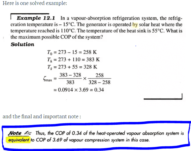

I still confuse about COP of refrigerator. When i read some journal, it is said that COP of VCRS can be greater than 1 (usually 2 - 4). But, why the COP other than VCRS usally lower than 1? like vortex tube, vapour absorption refrigeration system, etc.
Actually, now i am doing a research about vortex tube as air conditioner, but i stuck in COP because it has very small COP just 0,2

I found this when searching in other forum about COP. the forum discussed about COP of Vapour absorption refrigeration system. and somenone post a photo from this book "C.P. Arora “Refrigeration and air conditioning”" and the book says that "COP of 0,34 of vapour absorption system is equivalent to COP of 3,69 of vapour compression system".
So, that why i asked, if i have the COP of 0,2 of a vortex tube system (this my case), can it be equivalent to COP of 2 Vapour Compression Refrigeration Systems?

thanks for the explanation. So, it is mean that we can't compare COP of a system with the other system?
This presentation, starting on slide 11, may help:
https://www.slideshare.net/IanLouiseCelestino/simple-vapor-absorption-refrigeration-system
It looks like in the example problem conclusion you highlighted, they are considering the input heat to be free (which is often reasonable), so they are omitting it from the COP calculation after the fact, which leaves just the normal Carnot refrigeration equation: electrical work in divided by cooling out.
No, I would not say this aplies to vortex tubes at all. Vortex tubes do not use waste heat that you can ignore. They use a compressor (input power) and generate cold air (output cooling).
