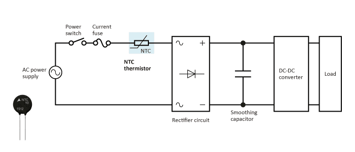

Basically I would like a device that when the coffee maker asks power, it slowly ramps to full power over a couple seconds.
One such device is an NTC (negative temperature coefficient) thermistor. We use them to limit inrush through relays to capacitive loads (to keep the relays from getting fried by the high inrush current). But unless you know what you're doing electronics-wise, that probably isn't a solution for you.
https://product.tdk.com/en/products...c-limiter/technote/img/apn-ntc-limiter_01.png

$2 NTC thermistor on Amazon sounds like a cheaper option than my battery idea.
Yeah, but I haven't found any that are pre-packaged as a module so far. You would need something that had safety agency markings on it to be sure it was safe. The suckers get pretty hot too, so you have to be careful about thermal management in their applications.
