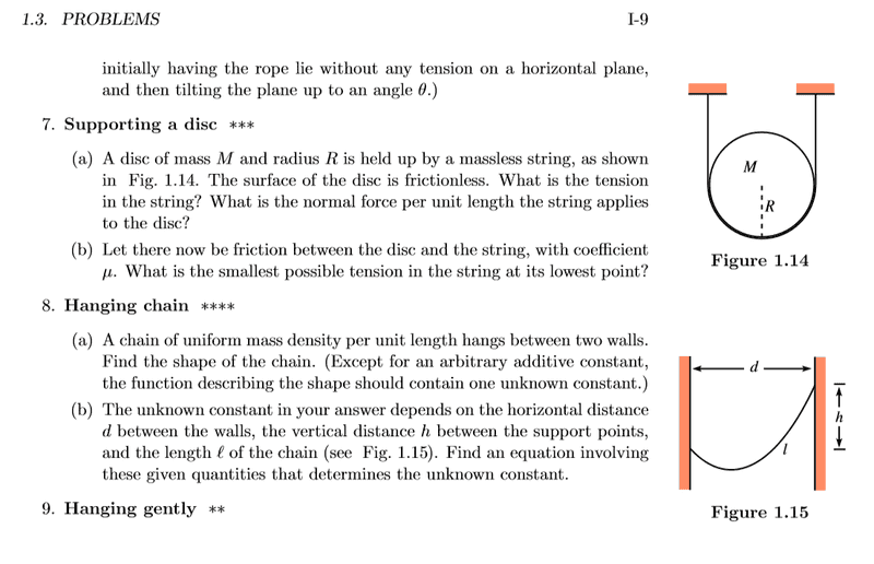

When will the tension the same throughout a rope?
In summary, the conversation discusses the concept of tension in a massless string with no friction. It is concluded that the tension must be constant in order to prevent the string segment from shifting in the direction of greater tension. The question raised is why this assumption is made for a specific problem involving tension.
Clara Chung
304
I have the solution of the questions and I don't understand why the tension in Q7 is assumed to be uniform throughout the rope, however the tension in Q7 is not the same throughout the rope (i.e. for a segment dl, the tension in each side is T(x+dx) and T(x) respectively.)
Thank you for your help.
If the string is massless and there is no friction then the tension must be constant. If not, the string segment would shift in the direction of the greater tension.
