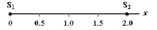

Two point sources emit sound waves of 1.0-m wavelength. The source 1 is at x = 0 and source 2 is at x = 2.0 m along x-axis. The sources, 2.0 m apart, emit waves which are in phase with each other at the instant of emission. Where, along the line between the sources, are the waves out of phase with each other by π radians?
The correct answer is x = 0.75 m, 1.25 m.
Δ γ/λ = ϕ/2 𝝿
I know that at the antinodes, the diffrence is pi radians and i got 0.25, 0.75, 1.25, and 1.75. for the position of antinodes. but the answer is x = 0.75 m, 1.25 m.
I can use drawing to obtain the answer, but my calculation gives me 0.25, 0.75, 1.25, and 1.75. Where am I doing wrong? Thanks!

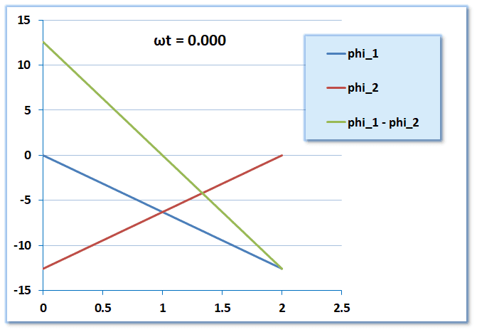

Always good to make a drawing. Does it look like mine below ?
Blue: ##\phi_1 = \omega t - kx\ ## running from the left to the right and
Red: ##\phi_2 = \omega t - k(2-x)\ ## going he other way.
Green: ##\phi_1 - \phi_2 ## going from +4##\pi## to -4##\pi##.
If ## \omega t ## increases, the blue and red lines move up, the green line stays in place.
One can argue that the phase difference ##|\Delta\phi|\ ## is ##\pi## at 0.75 and 1.25 m and that the phase difference is 3##\pi## at 0.25 and 0.75 m. Hence the book answer.

How so ? At the sources the waves are in phase at the instant of emission: $$
\begin{align*} t &= 0, \ x = 0\ \Rightarrow \ \phi_1 = 0\ \\ t &= 0, \ x = 2\ \Rightarrow \ \phi_2 = 0\
\end{align*}$$ Points at e.g. distance ##d## away from one of the sources have to wait ##\ d/\lambda\; T## so they lag by ##d/\lambda * 2\pi## . Blue and red line in #5: the phase.
Green line is phase difference ##\ \phi_1 - \phi_2\ ## , NOT modulo ##2\pi\ \ ## (*)
At x = 1 ##\ \phi_1 - \phi_2\ = 0## : same phase for all time
At x = 0.75 and at x = 1.25 you see ##\ \phi_1 - \phi_2\ = \pm \pi ##
(*) This is the core of the discussion: we are so used to this modulo ##2\pi##

You mean 'nodes', not 'antinodes'. The phase diffference (between two waves) at a node is (2n+1)π where n = 0, 1, 2, 3, etc.
At x=0.25m, Δϕ=3π
At x=0.75m, Δϕ=π
At x=1.25m, Δϕ=π
At x=1.75m, Δϕ=3π
All these points are nodes but the question does not ask for node positions – it asks for the points where the phase difference is π. Only x= 0.75m and x=1.25m satisfy this.
