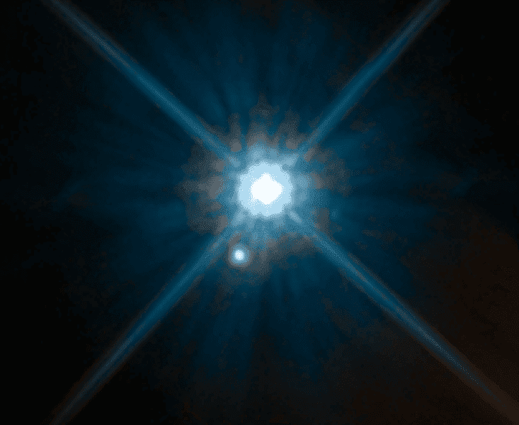

Ah! unfortunately I'm not the guy to discuss optical physics with, however you are in luck as this site has plenty of talent that should answer your questions. I did notice that today's Hubble image is a white dwarf, if its downloaded at full resolution and you zoom in it doesn't look too shabby, still not what your looking for but it is rather cool to look at. :smile:
http://hubblesite.org/image/4043/gallery
Likes AnotherParadox

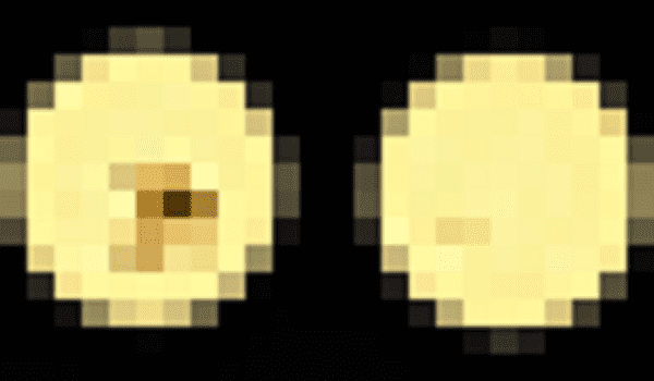

Big starspots could be visible in 10x10 images.
I took http://www.skyandtelescope.com/astronomy-news/star-spins-show-ages-010820143/ and compressed it to 10x10 pixels, then enlarged it again to make an image of reasonable size. This is the result:
The actual images will probably look a bit better in the center and worse at the edges, as angular resolution and pixel size are not the same thing.
With multiple images of that quality you can learn a lot about starspots.
