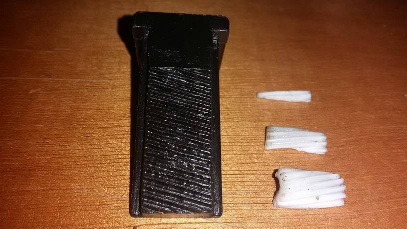

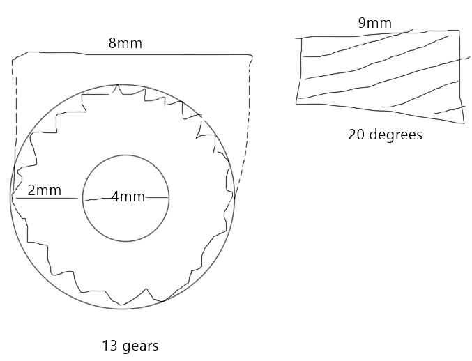

So I have a broken plastic pinion gear that belongs to my microscope and I'm wondering if there are standard sizes or how am I supposed to get a replacement? How do you guys find the gears you need? Seems like a pretty hard thing to find online.
It's an helical pinion gear. I have the dimensions but it's a small piece and I don't know if it's possible to 3D print something like that.

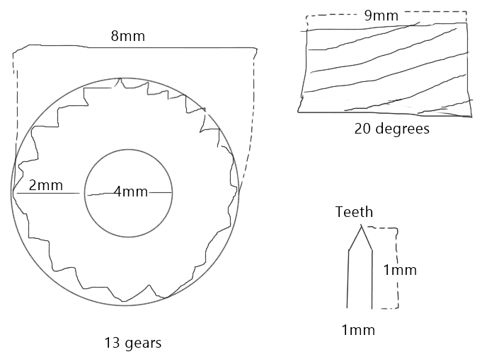

Just in case here are the dimensions, sorry for the bad quality drawing:

I think what you are looking for is a "screw gear", not a pinion gear (although it acts as a pinion gear).

It may be possible to use modelling clay to make a copy. Use the rack as a master to copy the tooth profile. Then make a mould from the clay and cast your replacement pinion from epoxy.

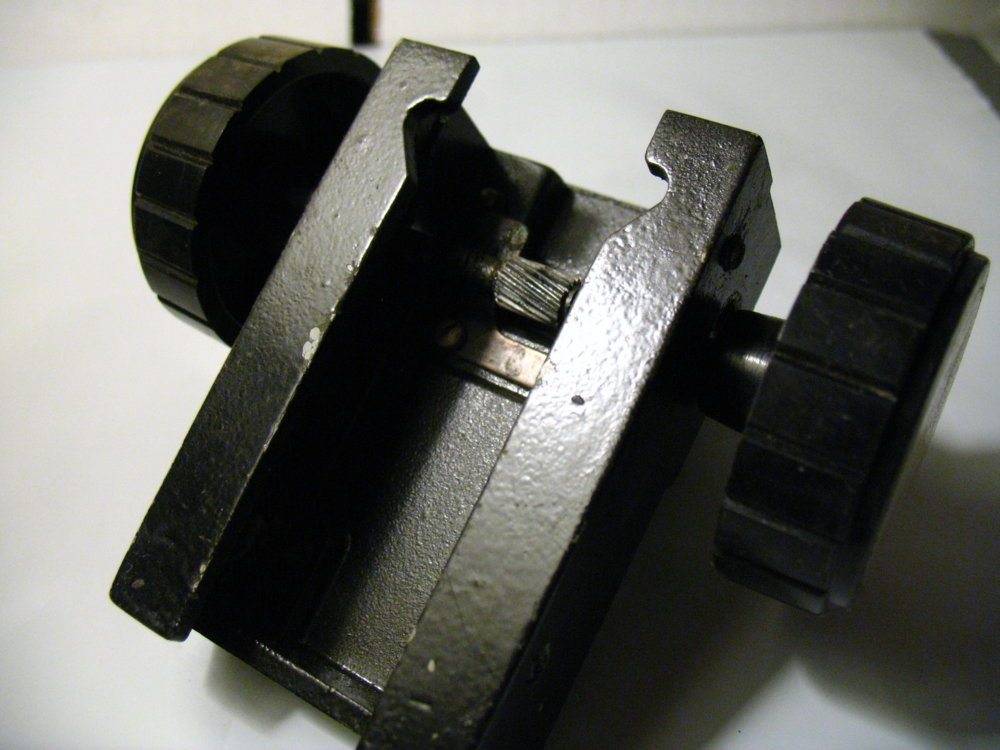

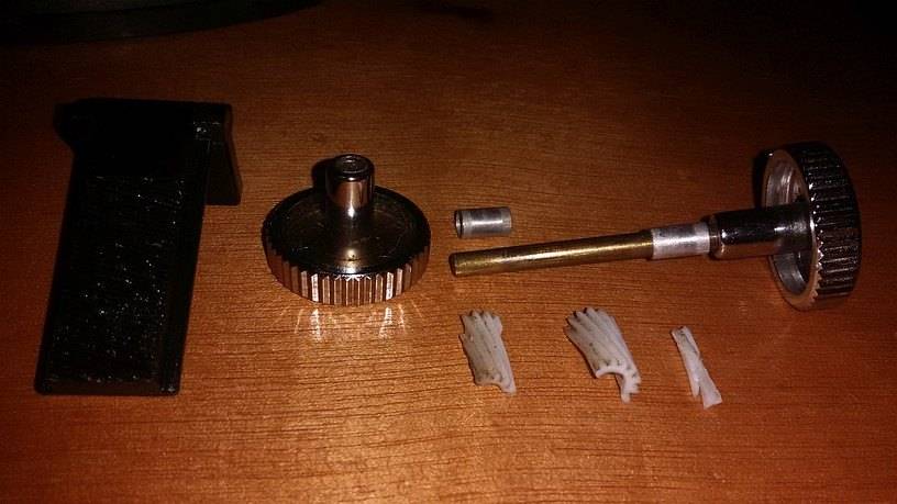

Thanks for the answers. The brand looks like HOC, I included a picture. I don't know about the model. The gear drives the rack.
Rack and gear:

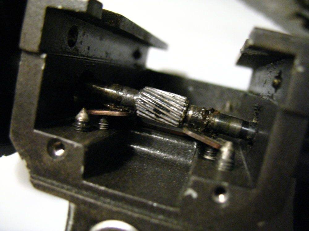

The gear goes into a 4mm metal shaft:
Is this for the focusing rack or the stage table cross fed?
Can you provide an overall image of the adjoining structures?
It's for a rack that moves up and down in order to focus.

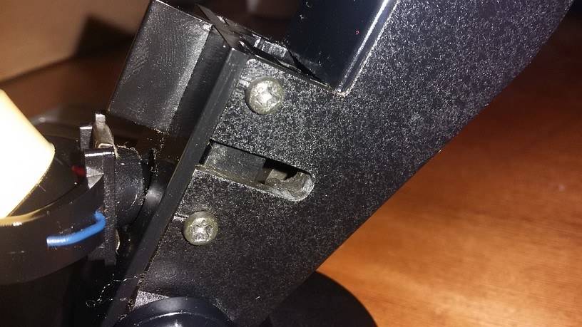

This is the entire mechanism
The metal shaft goes into this hole in the microscope (the one between two screws) and at the top you can see where the rack goes:
Can you see how the plastic gear was afixed to the shaft?

I figured out the brand, It's a Japanese Y.K.S HOC microscope It's "vintage" and I doubt I'll find a spare part. So I guess I'll have to figure out how to get one done for me or adapt something else. The gear looks so simple, I thought I could simply google for one.
Only pressure, it's a 4mm hole

The gear is pushed in, friction, I guess it's nylon or some plastic that can expand a bit
boston gear may have what you need
So you think the gear was just pressed onto the shaft? There are no set screws, shaft keys or square bosses to prevent the gear from rotating relative to the shaft? Mmmmm. Plastics do not do well under long term constant stress, due to their creep characteristics.
Yeah, they just pressed it, probably explains why it broke off.
Because it is a helical gear it will run smoothly in that application even if it is not perfect.
You might turn up a brass cylinder in a lathe.
Drill the hole undersize, then press it onto the shaft.
Mark the tooth ridge lines on the surface of the cylinder.
File or dremel the teeth to approximate shape.
Roll the gear on the rack to identify high spots that need more work.
Reassemble with grease on the rack.

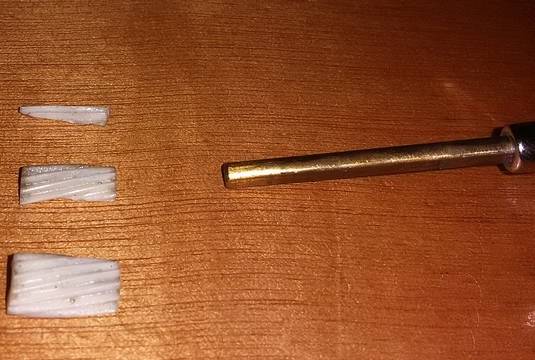

Try sticking the broken gear back with super glue?
Unfortunately I did it already and it broke off again, now it has so much glue that I can't glue it back into its original shape.

Thanks for all but it won't work, that's a right handed gear and I need a left handed one, I also preffer it to be plastic so it doesn't grind the plastic rack mechanism. I think I'll try to find someone who can make one for me but thanks again.
